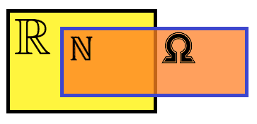

My statement:
The first transfinite ordinal, omega is the first number that cannot be expressed by any natural number, therefore it is not included in the set of natural numbers. The set of natural numbers is a subset of real numbers, every natural number can be taken out of it, but still true that there is no integer number in it that is capable ("big enough") to pair with omega. By this, it is also a good statement to say that the set of transfinite ordinals and the real numbers are disjoint sets.
Is this a good tought? If this is not, then can be refined to make it mean that "omega is after the finite numbers therefore it is after also any real number"?
Please help me to make this statement more formal.
Is the Venn diagram below correct?
Thank you!

First of all, there is a difference between ##\omega##, the first infinite ordinal, and ##\Omega## the first uncountable ordinal.
Anyway, you are correct that the only thing that ##\mathbb{R}## and the ordinals have in common is ##\mathbb{N}##. They are not quite disjoint.
If you want to make precise that ##\omega## is bigger than any real, you'll need the surreal numbers.
Likes zrek
It seems a bit of a mix. First, I do not recall seeing upper-case omega Ω used for either the first transfinite ordinal (which is usually lower-case omega ω) or the first transfinite cardinal (which is aleph-zero ); nor have I seen it used for the first uncountable ordinal (ω1) or the first uncountable cardinal (Aleph-1), nor the cardinal corresponding to the real numbers (Which is 2aleph-zero I have seen Ω as the class of all ordinal numbers. "Number" is a bit vague. In any case, one cannot automatically associate the first uncountable ordinal with the The next term you could make more precise is "after". For ordinals, "bigger than" corresponds to set membership, but for size, cardinalities are usually compared. Your idea that "ω is after the finite numbers" is vague, but I would presume that this means that every finite ordinal is a member of ω. Even vaguer is "it [ω] is after also any real number". Since you are attacking this in terms of sets, you will need a good definition of a real number as a set. I am not sure how you intend to make sense of that statement. As far as your Venn diagram: if we stretch a point and take the set of real numbers to be the set of all subsets of the natural numbers, then yes, ℕ⊂ℝ. ω and ℕ could be argued to be the same unless you are a purist. Since I don't know what you mean by Ω, I do not know where that should go in your diagram.
My feeling is that you want to use some sort of transitivity, saying that saying that "a real number r is less than a finite natural number n which is less than ω , therefore r is less than ω." But this doesn't work: the first "less than" is according to a metric, the second one is set membership. So they are two different relationships, so transitivity doesn't apply.

I used upper case omega, because I tried to symbolize the second part of this set, in which the lower case omega is only a member:
##0,1,2,\cdots, \omega , \omega +1, \omega + 2, \cdots , \omega+\omega, \omega + \omega + 1, \cdots##
So the upper case omega represents the ordinals that can not be represented by natural numbers. Maybe this is not a good idea, I'd be happy to follow your suggestions.

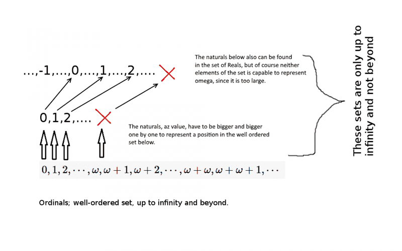

Thank you for your effort trying to understand me, I'm sorry for my lack of english. I created an image with elementary school logic, hopfully this tells more about what I'd like to explain by a simple Venn diagram (if it is possible to do correctly).
nomadreid said:
...are you saying that no natural number "represents" ℝ, or that no real number represents ω?
I'd like to say that that no natural number and no real number represents ω, even if the Reals is the superset of the Naturals (and have much bigger cardinality).

Again, we can only get somewhere on this if you can tell me what you mean by "represents".
Thank you, but I think at least with difficult topics and mathematical language I have not enough experience, so please feel free to fix my wording if you find obvious errors.
I mean some kind of mapping between the sets (just like I tried to demonstrate on the picture). Not exactly bijective, but some kind of a "value keeping" matching, just like between the Naturals and Reals. The connection between Naturals and Reals is not just a simple "one is a subset of the other", but there are more strict rules. By this, if we take the transfinite ordinals from 0 to say omega+1, one by one mapping them to the Naturals, we run out of naturals. If every natural is mapped to a real, and if we keep the rule (that I tried to describe above) then we also would run out of reals.
To make it short, what if my question is:
Is it possible to create a simple Venn diagram that describes the relations between the Transfinite ordinals, the Naturals and Reals? Is there a describable relation at all between them that tries to explain the difference between "up to infinity" and "beyond infinity"? Is this thought have a mathematic sense at all?
Let us start with this key fact: ordinal numbers are linearly ordered under set-membership. That is, for any three ordinals α,β,γ, α∈β∈γ⇒ α∈γ. You wish to use subsets, so we can use: for any two ordinals α,β α∈β ⇒ α⊂β. Put the two together, and you get that the subset relation is transitive: α⊂β⊂γ⇒ α⊂γ. So, treating your naturals and reals as ordinals, then there would be a straightforward Venn diagram of all ordinals like the diagram from Wiki that you cited, with the naturals being a subset of the reals being a subset of a higher ordinal, and so forth, and an embedding from one ordinal into a bigger ordinal could be the identity. In other words, the "value-preserving" maps would be fine. (The counter-intuitive thing in the Venn diagram is that two different ordinals, one a subset of the other, can nonetheless have the same size, i.e., cardinality, as one another.) Up to infinity would be the elements of ω, and beyond that would be beyond the smallest infinity. ("Beyond infinity" would not make sense, though.) I think that would answer your question, but if not, try again.
