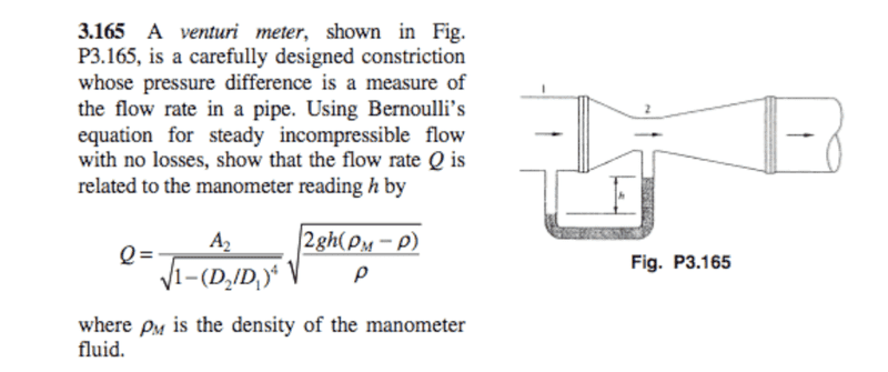

So I got that the pressure difference is gh(ρm-ρ). So I rearranged Bernoulli for p1-p2 to get (assuming the potential is the same I eliminated it),
p1-p2=½ρU22-½ρU12
I carried on rearranging to get:
√(2gh(ρm-ρ))/ρ = Q/A2-Q/A1
I am unsure how to eliminate A1 so I can proceed with the question

Looks like you made an error in the rearranging. I'm not sure, but it appears that you assumed that ##\sqrt{U_2^2 - U_1^2} = U_2 - U_1##
How can you express A1 in terms of A2 and the diameters D1 and D2?
Thank you it seems I did.
Oh I see, if I use A1U1=A2U2 And rearrange for U2, and use d2/D2 for the area ratio?

Yes. But you might want to rearrange for U1. Depends on how you are doing the algebra to get to the result.
Thank you! I got it now! :)
