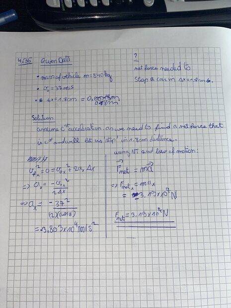

hello guys can someone verify my solution (in the picture) whether the solution is correct or I guess the steps followed would be enough. There is no solution in the book for this one but wanted to be sure.
Thanks in advance

You used 37 m/s for the initial velocity of the car when it is given as 37 km/h. The method is correct.
Likes simphys

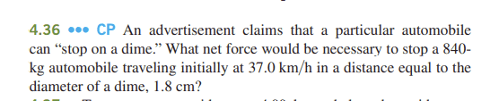

Why does your homework statement talk of a 850 kg car traveling at 45 km/h when the question you copy says a 840 kg car traveling at 37 km/h?
Note v0 = 37 km/h, NOT 37 m/s!
First rule of any test is READ THE QUESTION ACCURATELY.
Edit; kuruman got there first!
Likes simphys

Thanks guys, appreciate it! And well no.. I mistakenly copied the wrong question. I typed it in google but found a question on cheg from the same book (other edition) with just the numbers changed hence why, my apologies

Velocity used in the calculation should be 10.28 m/s.
After you calculate the force necessary to stop in 1.8 cm, just for curiosity, you could see how much force the maximum available static friction (rubber-asphalt μ is around 0.8) would actually allow, as well as how big of g-force the passengers would experience.
