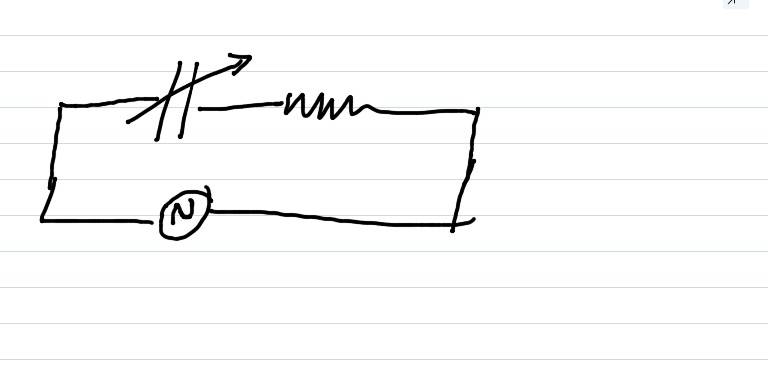

In the circuit shown in the figure below, the hase difference between the current and the voltage is 30 degrees, show how could you verify the capacitance of the conductor so that the phase difference could be 15 degrees.

Conductance is the reciprocal of resistance. What you have in the circuit is a capacitor (or condenser).
I didn't check your actual values step by step, but your approach is correct. Also, the new capacitance is coming out to be more than the old capacitance, which is correct (can you think why?).
Oh, sorry, I corrected it.
