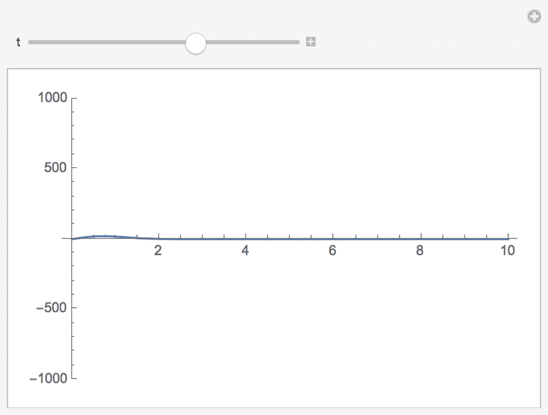

Hey, sorry for this late reply, but I thought I would go ahead and post in case someone needs this thread in the future! s0 is a function of s01 ( a constant) and t.
Substituting into that equation is getting very messy, so I decided to set all of the constants to zero and graph the solution for something like this...
For values of t greater than 0 (where there is an asymptote) and less than 10 ish (where that bump there starts to grow)
For values of t close to zero the graph looks like this:
I suppose this is implying that the solution is approximately correct during a certain time range...
Oops, that's set the constant to 1, not zero.
