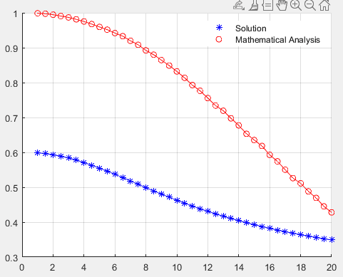

user_01
Given two i.i.d. random variables $X,Y$, such that $X\sim \exp(1), Y \sim \exp(1)$. I am looking for the probability $\Phi$. However, the analytical solution that I have got does not match with my simulation. I am presenting it here with the hope that someone with rectifies my mistake.
$$\Phi =\mathbb{P}\left[P_v \geq A + \frac{B}{Y}\right] $$

**My solution**
\begin{multline}
\Phi = \mathbb{P}\left[ a\left(\frac{b}{1+\exp\left(-\bar \mu\frac{P_s X}{r^\alpha}+\varphi\right)}-1\right) \geq A + \frac{B}{Y}\right]\mathbb{P}\left[X \geq \frac{P_ar^\alpha}{P_s}\right] + {\mathbb{P}\left[0 \geq A + \frac{B}{Y}\right] \mathbb{P}\left[X \geq \frac{P_ar^\alpha}{P_s}\right]}
\end{multline}
Given that $\mathbb{P}[0>A+\frac{B}{Y}] = 0$
$$ \Phi = \mathbb{P}\left[a\left(\frac{b}{1+\exp\left(-\bar \mu\frac{P_s X}{r^\alpha}+\varphi\right)}-1\right) \geq A + \frac{B}{Y}\right] \exp\left(-\frac{P_ar^\alpha}{P_s}\right) $$
consider $D = A + a$, $c = \frac{\bar{\mu}P_s}{r^{\alpha}}$
$$ \Phi = \mathbb{P} \left[Y \geq \frac{1}{ab}\mathbb{E}_Y[DY + B]. \mathbb{E}_X [1+e^\varphi e^{-c X}] \right] $$
$$\Phi = \exp\left(-\frac{D+B}{ab}\left(1 + \frac{e^\varphi}{1+c}\right)\right)\exp\left(-\frac{P_a r^\alpha}{P_s}\right) $$
I did not include the whole intermediate steps in the above solution which may cause confusion. Hence those steps are now presented below.
**My solution**
\begin{multline}
\end{multline}
Now consider only the first part of the expression on the right side of the equation, and letting $c = \frac{\bar{\mu}P_s}{r^{\alpha}}$.
$$ \mathbb{P}\left[a\left(\frac{b}{1+\exp\left(-\bar \mu\frac{P_s X}{r^\alpha}+\varphi\right)}-1\right) \geq A + \frac{B}{Y}\right] = \mathbb{P}\left[\frac{ab}{1+\exp\left(-c X+\varphi\right)}-a \geq A + \frac{B}{Y}\right]$$
consider $D = A + a$, and with mathematical manipulations, we get:
