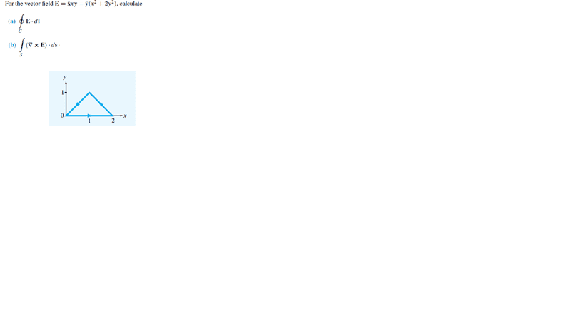

The goal is to verify Stoke's Theorem. I've uploaded the image showing the problem and diagram. I'd like to get a double check on my work as I work on part b.
Curl in cartesian coords and vector E.
Integral of E dot dl = Integral of (Curl of E) dot dS

To clarify some points, the bottom of the triangle is at y=0, the right side is y = -x+2, and the left side is y = x.
The arrows you see next to the equations represent which side of the triangle it references.

Problem: https://imgur.com/a/GCPYH
