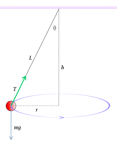

I made notes on this in class, but I did not understand everything about it. So, what I know is that vertical motion is when the object goes around in a circle like this:
And horizontal I guess it is like this:
But then I am very confused regarding what my teacher told me for horizontal motion. She told me there is the top and the bottom for horizontal motion which I completely do not get because it is always at the same distance to the ground, and so the tension is perpendicular to mg but the force diagram she given the class is just not like that. The 'experiment' was called ''rotating rubber on a string (horizontal) - assuming the string is horizontal''.
For the 'top' (I still don't know how top and bottom exists here) it is mg + T = Fc and for bottom T - mg = Fc.
Could someone please explain if I am misunderstanding what she means by horizontal motion or explain how top and bottom exist?

Hello the reason I said I guess is because the teacher didn't actually draw diagrams for any of the two... She simply gave us the equations that show what creates the centripetal force in the two cases of ''rotating rubber on a string (horizontal) - assuming the string is horizontal'' which I she given as top being mg + T = Fc and bottom T - mg = Fc. And the vertical was ''rotating rubber bung on a string (vertical circle) - at the top and the bottom of the circle'', which she noted as top T + mg = Fc and bottom T - mg = Fc.
I've placed the diagrams so you can see how I am considering the vertical circle rubber and the horizontal circle rubber... What I want to know if I am interpreting it correctly or not, whether the diagrams fit the cases, and what thereof makes the equations for top and bottom of the horizontal correct, because the vertical I can deal with, I do understand if the diagram I've drown for it is right.

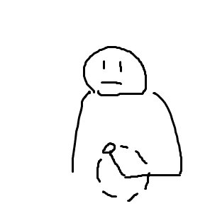

The core of my problem is that when I think of a vertical string is like when I spin a mass on the string in circles like this:
(Sorry for the bad drawing, the bit that is joined with the body is the hand holding the string)
But when I think of a rubber rotating on a HORIZONTAL string I thought that what is is the diagram given above, but it doesn't make sense to say there is top and bottom to that so I don't know what it means anymore for a circular motion to be horizontal...

Normally, in the string horizontal case (no gravity) the tension T is constant and T = mv2/R.
It makes little sense to talk about a horizontal case with gravity because the mass would have to rotate infinitely fast to get the string horizontal (see conical pendulum below).
Vertical case
In the string vertical case (with gravity) the tension varies.. At the top the magnitude of the tension |T| = mv2/R - m*g. You can see from this that If the object rotates too slowly mv2/R will be smaller than mg, the tension will go negative and the string will go slack. At the bottom the magnitude of the tension |T| = mv2/R + m*g
Conical Pendulum case
The second diagram in your original post shows a third option with the string neither horizontal or vertical. This is called a conical pendulum. The tension is constant and there is no "top" or "bottom" to the problem. You can write two equations..
In the vertical plane. The mass isn't accelerating so m*g = Tcos(θ) .
In the horizontal plane.. mv2/R = TSin(θ).
These two can be solved to give an equation for the angle θ for any particular velocity v. That's done here if you want to see the maths..

I checked out Conical Pendulum on wiki. They have a diagram (I'm linking this direct from wiki):
This looks like the horizontal diagram in the OP, no?
