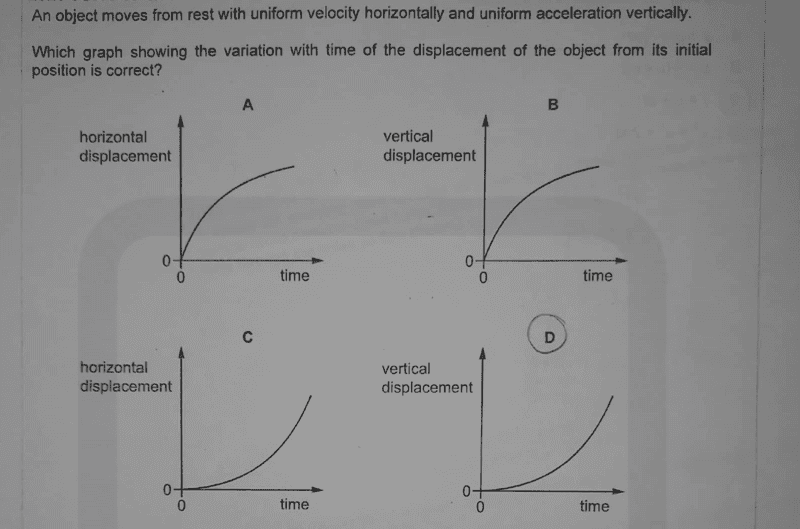

image below
suvat equations
my answer was D, which is correct considering the motion downwards eg, object thrown from a cliff
but what if an object is moving up?like a football being kicked?
i cant understand how this graph applies to that...
What can you say about the components of the velocity in each direction from the 4 graphs?

It doesn't necessarily have to. It didn't say that a single graph must apply to all possible scenarios. If you were shown four pictures and asked which one was a dog, then you could identify the dog. But, it doesn't mean all dogs look like that. If it's a chihuahua, then it doesn't look like a St Bernard.
I would have said D is a rocket accelerating upwards.
To what @PeroK said, I would add that none of the 4 plots shows the correct horizontal displacement vs. time. Do you see why that is the case?

the correct horizontal displacement with time would be a straight line passing from origin
RIght. Do you see any straight lines?

I know what you were asking. I wanted to make sure that you understand why A and C cannot be correct because they lines are not straight.
Now how do you know that the answer is D? If you toss a rock with some initial horizontal and vertical velocity it will go across at constant velocity while, in the vertical direction, it goes up and then back down. Which of the two graphs looks like that is the case, B or D?

Are you saying that graphs B and D are inverted, i.e. that a downward displacement is positive?
How do you know that? It does not say so. If you choose instead that up is positive then that makes the correct answer B.

Except that the question itself does not say "projectile motion". And, graph B has non-zero initial velocity.

True, which means that when it says it moves from rest with uniform velocity horizontally it intends that that velocity is purely horizontal. I had read it as unspecified vertical velocity. With my reading and a vertical acceleration that could be up or down both B and D could be correct.

There is nothing wrong with the question. Since it moves from rest the initial slope of the graph must be zero. Choice B lacks that feature. It shows an object with a nonzero initial velocity.

It is not clear what is meant by "moves from rest". That conflicts with "constant horizontal velocity" unless that is zero.
Calm down everyone, there is nothing wrong with this question.
  • At time t = 0 the object is at rest.
  • At time t > 0 the horizontal component of velocity is constant so the magnitude of the horizontal displacement increases linearly wrt time. This rules out answers A and C.
  • At time t > 0 the magnitude of the vertical component of velocity is increasing at a constant rate so the magnitude of the displacement increases quadratically wrt time. This rules out answer B.
  • This leaves the answer D, which can be interpreted either as the vertical displacement downwards of an object falling under gravity or as the vertical displacement upwards of a rocket accelerating upwards at a constant rate.
Note that answer B does meet the criterion "uniform acceleration vertically" where that acceleration opposes an initial velocity (e.g. for an object thrown upwards) but the question states that the object has no initial velocity: it is at rest.

It means that at t = 0 velocity is zero.
No it doesn't, because this describes the situation when t > 0. Of course if the constant horizontal velocity is non-zero for t > 0 then horizontal acceleration at t = 0 would be infinite, but there is nothing in the question to rule this out, whereas if you want to interpret answer B as correct then vertical acceleration at t = 0 would be infinite, contradicting the stipulation of the question that vertical acceleration is constant.

If you can have a non-zero initial horizontal component, then you can have a non-zero initial vertical component, in which case both B and D are valid.
The question is a mess.

But you can't have a non-zero initial horizontal component ("an object moves from rest"), nor a non-zero initial vertical component, and so B is not valid.
That's what we all thought, until you starting telling us we were wrong:

You cannot have it both ways. If being at rest at ##t=0## with a discontinuous change at ##t>0## is allowed for the horizontal velocity then surely the same can be true for the vertical velocity.
This makes the stipulation that the object is at rest at ##t=0## irrelevant. That means that the wording is bad.
If the problem had mentioned an unknown horizontal impulse at ##t=0##, all would have been well.
