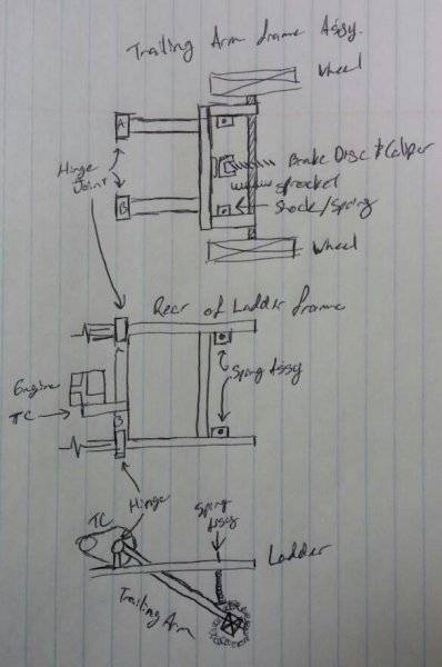

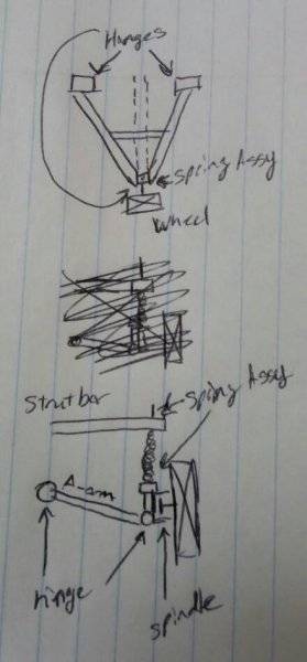

OK here's some rough sketches of the suspension designs, obviously not to scale. The front has changed a little from this drawing in that the spring assembly will not go directly through the strut bar, but through an eye bolt trailing behind it to allow for some rotation. The spring assembly is a simple thing, a spring (length and stiffness tbd) encapsulated between washers pressing against eye bolts on either end. The entire assembly will be fixed at the bottom by nuts on a bolt. The bolt will act as a guide rod for the assembly and the head at the top will act as a stop point to prevent over extension. So in theory I can pre-load the spring to a certain amount by shortening the guide rod, however, it would not be able to extend beyond the pre-load length. There is load on the springs even with the car at rest from gravity, total 767.5N spread over the 4 springs, or about 191.9N if I can obtain 50/50 weight distribution. Obviously since the length and stiffness of the springs is still in question, the travel of the suspension is in question. The stiffer the spring used the less it will have to travel, but the spring free length will be <..15m, and travel <.05m. Obviously the longer the spring the higher the ground clearance, but also higher center of gravity. I'm more concerned with the CG as the wheel track is only .76m, hence trying to use shorter stiffer springs. There will be no damper or oil filled shock to smooth things out, finding such a device in my scale and load usage has proven nigh impossible. I've tried using coil over shocks from other go karts, but because they are designed to carry 1 or more people, they are too stiff and don't react properly to my load.
Were my previous calculations done correctly? I thought they seemed high, but maybe I'm not accounting for something. The force of g on such a small weight doesn't off set the vertical force very much. I'd read somewhere in another thread about figuring the obstacle point of contact on the wheel as a lever, would that actually be appropriate?
