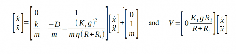

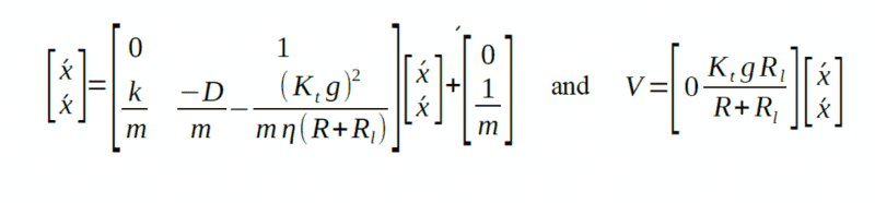

I am trying to understand what [x^. x^..] means, and information regarding the vertical format it is in .
Can someone please help me understand, or refer me to a website that can aid me. Thank you!The system is given by

I believe x^. and x^.. may refer to derivatives and the vertical format may have something to do with vector notation. I just need more specifics if I am to continue my investigation.

Here is the image of the expressions you're wondering about.
From your post I gather that the x with the grave' in the vector should be ## \dot{x} ## and ##\ddot{x}##, which are time derivatives of position, ##x##.

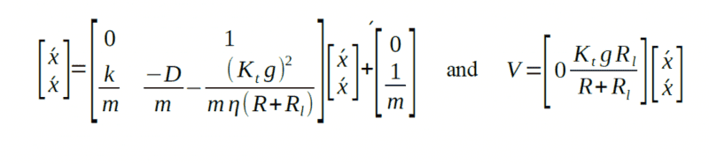

would that convert to [itex]\ddot{x}=\dot{x}[/itex], [itex](15000/m) \dot{x}-(10/m)-(1601.6^2/84.6m)\ddot{x}+1/m=\ddot{x} [/itex] and [itex]V= (240240/169.2)\ddot{x}[/itex]
I feel that I have done something wrong in the simplification of the matricies, could somebody assist me in finding my error?

Assuming the image SammyS posted (post #3) is correct, and assuming the vector has ##\dot x## at the top and ##\ddot x## at the bottom (they both look like ##\acute x## to me), then that is a correct expansion. That said, it does look mighty strange. The first equation would lead immediately to ##\dot x = Ae^t##.

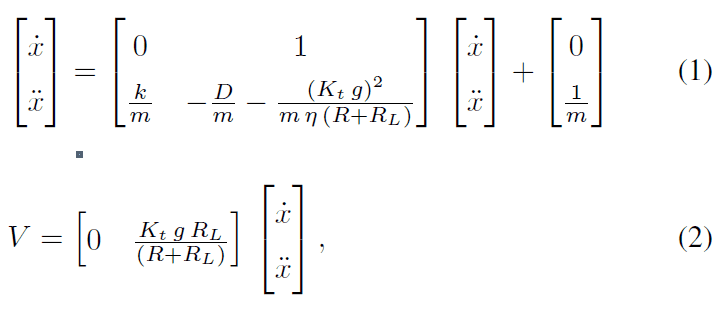

Here's an image of the matrix equations directly from the paper authored by Michel Smit.
(The image I posted in Post #3 was from the file attached to the Original Post in this thread.)

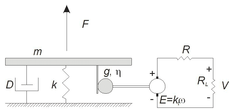

here is some info from post 1 and additional info.
The system is a floor tile that generates electricity when stepped upon.
where x is the position and V the voltage across the load resistance.
k= 150000 N/m The spring coefficient.
D=10 Ns/m Mechanical damping
Kt = 0.0728 Motor constant
g= 22000 rad/m gear ratio it should have been formatted rad/min which is still unconventional and should have been reduced to rad/sec or converted to RPM
Ƞ= 50% Efficiency gears
R= 19.2 Ω Internal resistance motor
Rl = 150 Ω load resistance
m=35 kg Suspended mass (without dancer)
The estimated mass of dancer given is 70-100kg

Paulides, J.J.H., J.W. Jansen, L. Encica, E.A. Lomonova, and M. Smit. "Human-Powered Small-Scale Generation System for a Sustainable Dance Club." 2009-EMC-143_revised, 2009, 4.
There, with that citation I should be allowed to post this.
Hopefully this can clear things up a little.

The more I think about the set up and compare it with the given equations, the more it seems to me the equations are nonsense.
Consider the k term. This should contribute ##-kx/m## to ##\ddot x##, not ##+k\dot x/m##.
I would have thought that the damper would contribute ##-D\dot x/m##, not ##-D\ddot x/m##. Indeed, the units given imply force/speed.
And the whole idea of having two differential equations involving x and its derivatives is an overspecification. It doesn't make physical sense.
Gravity has been left out, and I would have expected the mass of a person to come into it somewhere.
Fwiw, I get ##M\ddot x = -gM -kx -D\dot x - H\dot x##, where g is gravity now, M is mass of plate+(possibly) person, and H is a positive constant associated with the generator.
Check the ##-H\dot x## term. I could be wrong, but I believe the power generated will be V2/R, so is proportional to ##{\dot x}^2##. If so, then the magnitude of the resistive force is proportional to ##|\dot x|##, and the sign should be opposite to that of ##\dot x##.
