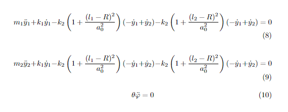

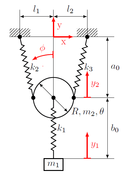

The problem states that for the vertical spring system below we give boundary conditions to the y positions of m1 and m2, so considering this I have to work out the equations of motion. The ring on the top is supposed to be moving only vertically.
Lagrange equations of motion

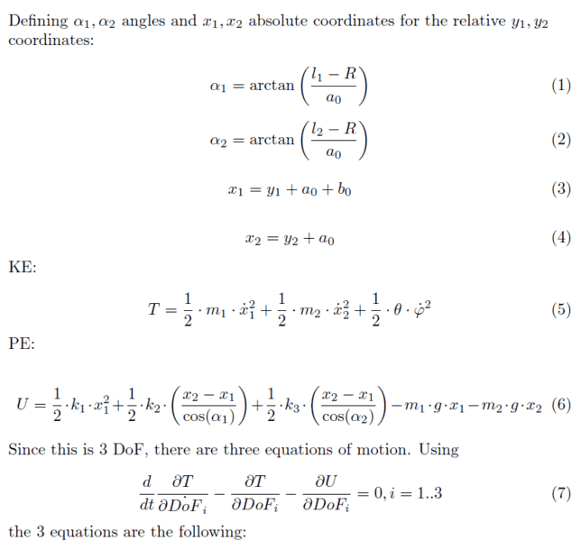

I am trying to solve this and get the equations of motion using the Lagrangian method.
I could do all the steps but the equations (especially the third one) seems..weird.
What am I doing wrong? Sorry if the equations aren't in their simplest form, they are pulled straight from Wolfram Mathematica.
I tried to explain my work in a little more detail below:

1. The original (complete/word-for-word-exact) question is missing. You have expressed the question in your own words. This may be OK but sometimes (often!) posters’ descriptions are incomplete and/or misinterpret the original question.
2. You say “the ring … is supposed to be moving only vertically”. But the ring appears to have the freedom to rotate about a horizontal axis through its centre while oscillating vertically. I’m guessing rotational motion is allowed and ##\theta## or ##\phi## is the angle of rotation.
3. The meanings of some parameters are unclear, e.g. ## \theta, \alpha_1 \alpha_2##. They should be shown on the diagram. (We can guess, but sometimes we'll guess wrongly.)
4. Are you using ‘x’ for both horizontal and vertical distances [Edit - and spring extension!]? That would be a dreadful source of confusion! Your potential energy equation (equation 6) seems to use ##x_1## and ##x_2## for the gravitational potential energy!
5. The kinetic energy term at the end of equation 5 appears to relate to rotational motion. But it makes no sense - it is dimensionally incorrect and doesn’t include the moment of inertia of the ring.
6. Rather than Wolfram Mathematica, you should formulate the various equations for yourself and include them in your posts. You should use LaTeX to format the equations here so we can read them easily. (You’ll get more replies/help if you create easy-to-read posts.) Here's the quick guide to LaTeX: https://www.physicsforums.com/help/latexhelp/. (This link is also below the bottom left corner of the edit window.)
