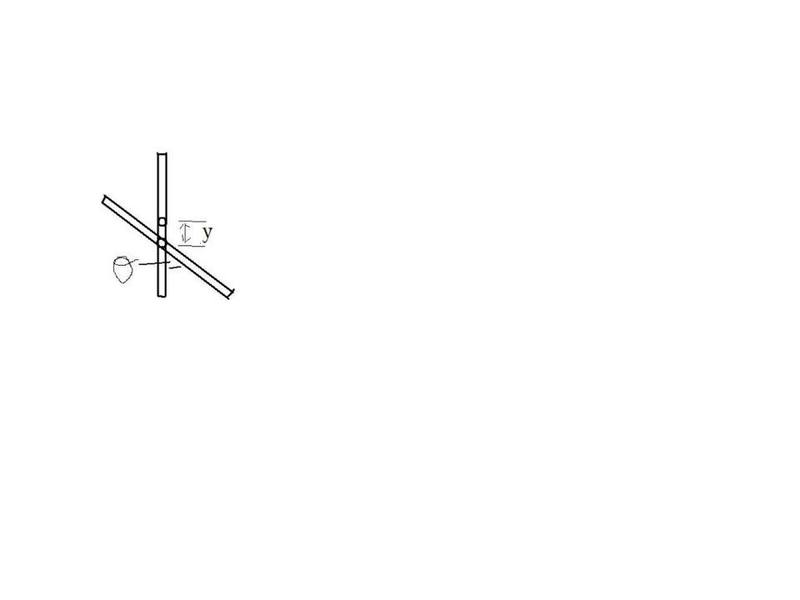

A uniform stick of mass m and length L, initially
upright on a frictionless horizontal surface, starts falling. The circle at the center of the
stick marks the center of mass. Derive an expression for the speed of the center of mass
as a function of y and θ if the stick falls as shown (with the center of mass moving
straight downward).
v=\frac{dy}{dt}; \omega=\frac{d\theta}{dt}
v_{cm}=r\omega; I=\frac{1}{12}mL^{2}
K_{rot}=\frac{1}{2}I\omega^2
K=\frac{1}{2}mv^2
There are no non-conservative forces so E_{mech} is conserved.
Therefore I figure: U_{i}+K_{i}=U_{f}+K_{f}
So: mg\frac{1}{2}L=\frac{1}{2}mv^{2}_{cm}+\frac{1}{2}I\omega^2
Then subed in v=\frac{dy}{dt} and \omega=\frac{d\theta}{dt} and
I=\frac{1}{12}mL^{2}, canceled out the (1/2) and m and attempted to integrate the equation.
mg and L are all constants right? So I got 0=2m\frac{dy}{dt}y+\frac{1}{12}2mL^2\frac{d\theta}{dt}\theta which I don't think is right..

Nope, not yet. (You can't have a sinθ term, which has no units, added to a length term. That's a tip off that something is wrong.)
Do this. Draw a diagram of the stick when it makes an angle θ with the ground. What's the height of the center? (Find the right triangle.)
This is what is supplied with the problem. Well, its my version of it :redface: but it's pretty accurate. Um, neglecting that part of the angled stick is somehow below the surface of the table :rolleyes:
oh heh heh.
Ok so its y=\frac{1}{2}L-\frac{1}{2}Lcos(\theta)..
That will work. (My diagram would just measure the position of the center from the ground, thus y = L/2 cosθ.) Now take the derivative of both sides.

So
\frac{dy}{dt}=\frac{1}{2}Lsin(\theta) ... in terms of my diagram? It would be negative for yours because as time increases, y is decreasing so the change is negative where as mine is positive because the change in y is increasing?
frozenguy said:
So
You left off dθ/dt.
oops.. you so
\frac{dy}{dt}=\frac{1}{2}Lsin(\theta)\frac{d\theta}{dt}
So do I solve for omega and sub that into my energy equation mg\frac{1}{2}L=\frac{1}{2}mv^{2}_{cm}+\frac{1}{2}I\omega^2 ?
Yes. Express ω in terms of vcm.
