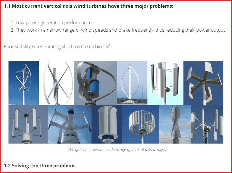

It seems that nesting the turbine blade structures will create shadowing, which will reduce efficiency significantly compared to using two separate turbine blade structures. Why design something on purpose that starts out life with a built-in efficiency degradation?
https://www.windpowerengineering.co...is-wind-turbine-technology-continues-improve/
