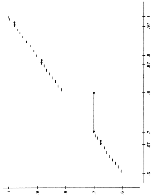

I have here a pretty tricky problem from Spivak's Calculus. There is a function that appears for the first time in Chapter 4 on Graphs in problem 19 item v, and then reappears in Chapter 5 on Limits in problem 5.
The function is
##f(x)## = the number obtained by replacing all digits in the decimal
expansion of ##x## which come after the first ##7## (if any) by ##0##.
In Chapter 3 we are asked to "describe as best we can the graph" of this function.
In Chapter 5, we are asked for which numbers ##a## the limit ##\lim\limits_{x\to a}f(x)## exists.
Problem 5 doesn't ask us to prove that the limits exist, however. I would like to know how if someone can provide at least a partial proof that the limit above exists at certain values in the domain.
I have quite a few questions about this interesting function.
Below you can see a graph of the function as presented in the solution manual
I believe the x-axis is vertical here.
The graph is composed of
i)
an infinite number of intervals that start on the ##y=x## line and finish at some ##x## with a decimal expansion ending in ##7\bar{9}##. E.g., from ##0.67## to ##0.67\bar{9}## which is considered ##0.68##.
Other examples of intervals would be
$$0.7\text{ to }0.7\bar{9}=0.8$$
$$0.6987\text{ to }0.6987\bar{9}=0.6988$$
$$0.6997\text{ to }0.6997\bar{9}=0.6998$$
ii) an infinite number of points on the ##y=x## line; these are points at which ##x## has either no 7's in its decimal expansion or one 7 followed by zeros. ##f## doesn't modify these numbers, as there are no decimal numbers to be removed.
Note: For some reason, the solution manual graph has some open intervals, e.g. ##(0.67,0.67\bar{9}]##, ##(0.7,0.7\bar{9}]##. I do not know why this is. For example, take ##x=0.6\bar{9}=0.7##. ##f(0.6\bar{9})=0.6\bar{9}##, so I understand that the point ##(0.6\bar{9},0.6\bar{9})## should be on the graph. This would be my first question about the graph.

It's weird, because the graph from the solution manual shows numbers such as .7, .6, .8, etc.
It also goes back to my question on why the intervals in that graph are open at such points as ##0.67##, ##0.7##, ##0.87##.

Yes. I would have expected the opposite. The one without the 9's. I think he's trying to be too clever.
Exactly, even Spivak caught himself out with his convention. Note that ##0## is still okay, as there's no alternative!
zenterix said:
The limit exists for every ##a \in \mathbb{R}## except at points where x has a decimal expansion that ends in ##7\bar{9}##, e.g. ##0.7\bar{9}##. At such points, the limit from below exists and equals f(a). The limit from above, however, seems to equal a. For example, for ##x=0.7\bar{9}##, the limit from below is ##0.7## and the limit from above is ##0.7\bar{9}##
Yes, I think that's right. The left-hand limit of ##f## at ##0.7\bar 9## equals ##0.7\bar0##. Although, Spivak has tripped himself up now, because that's not a valid decimal. It should be ##f(0.7\bar 9) = 0.6\bar 9##.
Leaving that to one side, the right-hand limit is ##0.8##, which must be written ##\equiv 0.7\bar 9##.
The limit, therefore, does not exist at ##x = 0.7\bar 9##.
