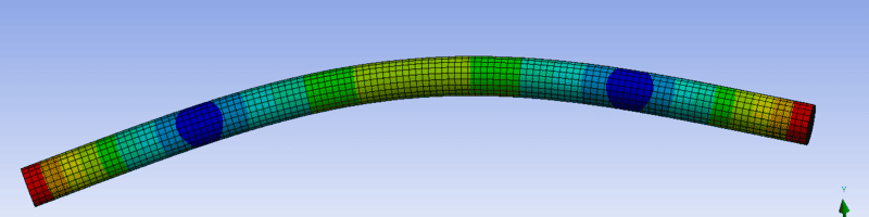

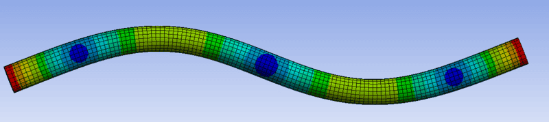

Thank you for the answers. To be more clear I have uploaded some images. I draw a shaft. When I run free free modal analysis first bending mode is 362,2 and second bending mode is 986,45 but when i fix the shaft from 2 sides the first bending mode decreases to 361,3 and the second to 980,9. What is the reason for that?
Fixed supports
First and second bending modes of fixed support
First and second bending modes of free free modal analysis
first bending mode
second bending mode

grejuvaa said:
When I run free free modal analysis first bending mode is 362,2 ... but when i fix the shaft from 2 sides the first bending mode decreases to 361,3
Show the mode shapes for those two cases. Compare the exact locations of the nodal points in the free-free condition to the locations of the inflection points in the fixed-fixed analysis.
