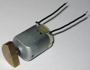

I am making a vibration project which requires me to mount eccentric weights on both sides of an electric motor. I must submit the "generated force(in Kg)" by this motor.The RPM of motor = 1000
Total weight on both sides of the motor = 16.8Kg (8.4Kg on both sides)
The radius(distance from the center of the shaft to the end of the weight) = 103 mmWhat will be creation of Centrifugal force when this motor is run at 1000 RPM ??Dhiraj
Where are you going to locate these weights? At what radius?
Think about the problem of tension in a string holding a rock and being swung in a circle. Your problem is similar.

take a look at this video. The motor has to be used like this. To vibrate certain appratus
also look at this image for weight placement
