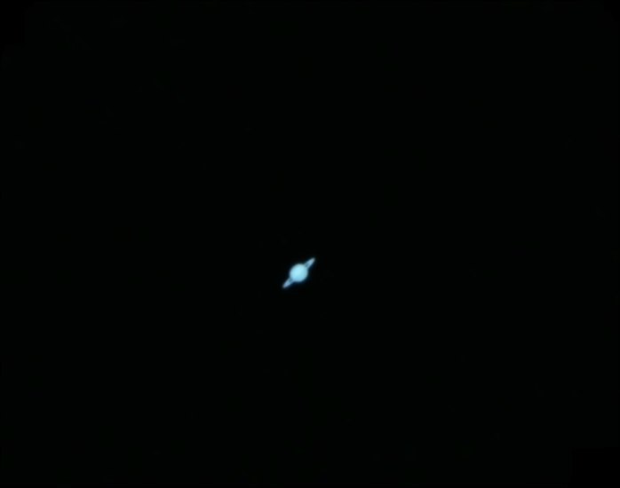

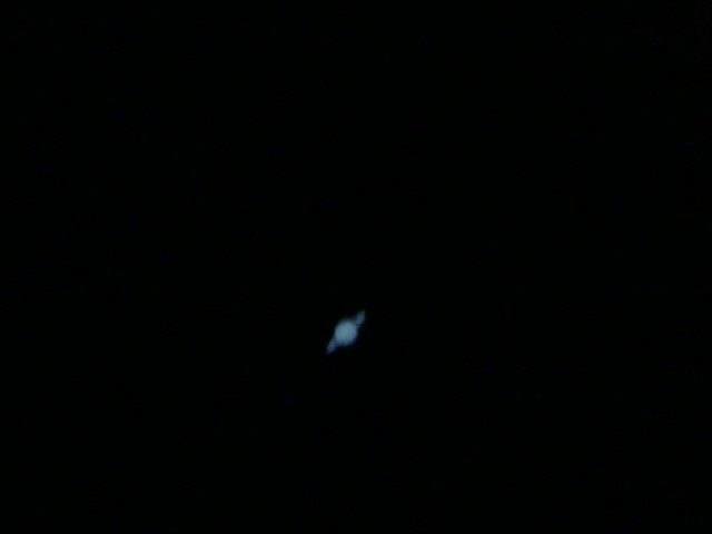

I can see something similar to the picture above but i can't manage to take a picture like that. All my pictures comes out tiny and an example is the picture below. What settings do I need for the picture and do i need a motorized scope to take pictures?
P.S. - The picture i took is from a digital camera and the exposture is set at 1/8 sec. The scope is not a motorized scope.

My pic above was taken with a webcam. Webcams actually get better results than regular digital camers because the technique is to take a large number of frames and stack them with software such as Registax.
In order to stack lots of frames, the saturn must stay in the same spot within my eyepiece? So do i need a RA motor for that?
No, but it helps. There are people who are able to get a webcam to snap a few dozen frames while it crosses the field of view. Trying to track manually can work too, but it can also make it jump around. Registax will follow the planet around and line-up the separate frames, but there is a limit to the "jumpiness" it can handle. You can also align them manually, but that can take a while if you have a lot.
