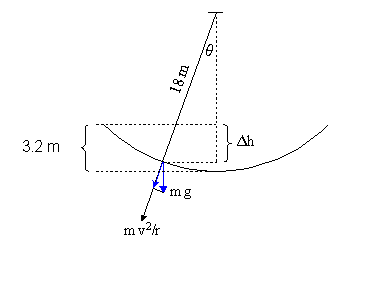

Tarzan, who weighs 618 N, swings from a cliff at the end of a convenient vine that is 18.0 m long (see the figure). From the top of the cliff to the bottom of the swing, he descends by 3.2 m.
A. If the vine doesn't break, what is the maximum of the tension in the vine? 837.733 N
B. The vine will break if the force on it exceeds 730.9 N. Does the vine break? If yes, at what angle does it break (if no enter 180. deg)?

You'll need an expression for the velocity with respect to angle (so, change in height gives the change in potential energy which leads to the velocity). Next, note that the centripetal force lies along the direction of the vine already. In terms of contribution to tension you can depict that as a centrifugal force at the end of the vine. Added to that will be the portion of the gravitational force that also lies along that vector.

I need to find an expression for velocity with respect to the angle? So when I am making this equation, will i need to take into account an angle with the Weight of Tarzan as well? I also know that I can make v^2=2gh. If I then used trig to find a relationship between h and the angle, such as h=R-Rcosθ. Would a method like that work?
Sure, use the potential energy change from the initial height to the current position in order to determine the kinetic energy and hence the velocity. Make sure that you're calculating the drop in height rather than the height above the nadir of the arc.

It's difficult to follow your logic when the variables (such as h1 and h2) are not defined. Even so, it should be clear that you need an expression for the velocity not a particular value, since the centripetal force will vary as the velocity does.
Essentially, you need an expression for the tension as a function of θ. This is comprised of the centripetal force and the component of the gravitational force that is aligned with it. The centripetal force depends upon the velocity, which in turn depends upon the gravitational PE converted to KE.

The distance by which Tarzan drops is not Lcosθ. Remember that the radius of the circle that he follows is 18m, yet his total drop is only 3.2m. So he only follows a small arc of the circle.
You'll need to further analyze the diagram in order to determine the extent of his descent with respect to angle.
If the arc radius is r = 18m and the total drop in height is h = 2.3m, then the drop as a function of angle (from vertical) is:
## \Delta h = r\;cos(\theta) - (r - h) ##

OH! I just figured it out! I am hesitant to put how to do it on here, that way when other people are trying to do the problem they will also have to go through the steps in order to figure it out. I know the method is correct because the angle that I got as an answer, I submitted to my online homework program and it was correct. Thank You very much for helping me, you helped more than you know.
