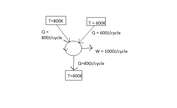

Explain whether or not the first or second law of thermodynamics are violated in the below cyclic process (see attachment)
Clausius Inequality, Carnot efficiencies, ΔS ≥ 0 for a cyclic process.
The first law is satisfied. The fact there are two hot reservoirs instead of one is putting me off a little bit since the K-P version of the second law only applies to heat entering the engine from a single hot reservoir. The generalized Clausius' inequality says that ##\sum_i \frac{\delta Q_i}{T_i} \leq 0 = \frac{600}{600} + \frac{800}{800} - \frac{400}{400} = 1## which is not less than zero. So the second law is violated. Is this all?
I was wondering if I could replace the two separate hot reservoirs with a single reservoir at 1400K? When I do this, I end up with ##\eta_C = \eta_E## which is not a violation of the second law, so I must have gone wrong in my attempts.
Many thanks.

Sometimes it helps to express the laws in a more general sense - avoids the need for wonderful exotic formulas.
1st law is conservation of energy.
... i.e. does tot energy out = tot energy in?
2nd law is the entropy law - entropy must increase or stay the same.
... what does that mean about the input energy and work?
Note: if the efficiency of this engine is equal to the carnot efficiency, what does it mean about this engine?

This is the case here. Heat in = 800 + 600, while heat out = 1000 + 400.
When the engine accepts heat it's entropy has increased. When heat is expelled or deposited into the colder reservoir, this tends to decrease it's entropy. The net entropy must be ≥ 0. Since the state of the substance is unchanged in an engine, the entropy of the surroundings has increased, which is accounted for in the fact that the engine does work.
The engine operates at the maximum possible efficiency. Is it okay to replace the two separate hot reservoirs as a single one?
You know - I don't actually know. If the effect of the single reservoir does not change the rate that heat enters the engine, then I'd say yeah.

Let me explain my attempt using the Clausius' inequality in words:
Increase in entropy of the engine is by definition Q/T where Q is the heat that enters the engine and T is the temperature of the reservoir supplying this heat. Suppose the engine is in a state ##S_i## initially. Then the increase in entropy is ΔS = Q1/T1 + Q2/T2, Q1=T1=800, Q2=T2=600. Heat 400J flowing out tends to decrease the entropy of magnitude Q3/T3 , Q3=T3=400.
So the net change in entropy is Q1/T1 + Q2/T2 -Q3/T3 which is not less than zero, so that's why I thought I had a violation of 2nd law.
However, comparing the efficiencies I see that eff of engine = eff of Carnot which is allowed. Since the formulations are equivalent I have a contradiction here.

Thanks for the link - I see now that they are not equivalent and I think i understand why: heat flows are additive and so the heat input into the engine is always the 1400J. But this does not mean that the temperature of the reservoir need be 1400K. (for sure it has to be at least this). Since the efficiency of an engine is dependant on the temperature of the reservoirs, the efficiency of the single combined engine is different to that of them separately.
No! You can't do that. That would be a great subject for a troll physics cartoon. If what you propose were allowed, suppose you have a single hot reservoir at temperature T that transfers ΔQ/cycle to the engine. Separate it into two reservoirs, each contributing half of the ΔQ/cycle. Now replace those two reservoirs with a single reservoir at temperature 2T that transfers ΔQ/cycle to the engine. Rinse and repeat. Infinite energy!
What you can do is replace the two hot reservoirs with an equivalent single reservoir whose temperature is somewhere between 600K and 800K. Take the upper limit: Can an 800K reservoir transfer 1400 J/cycle to a heat engine that produces 1000 J/cycle and transfers 400 J/cycle going to a cold reservoir at 400K?
Another way to look at this: You could certainly get more out of the system if that 600K hot reservoir was replaced with an 800K hot reservoir. Now you can combine those two 800K reservoirs, but it's not a 1600K reservoir. It's an 800K reservoir that is transferring 1400 J/cycle with 400 J/cycle going to a 400K cold reservoir and 1000 J/cycle going into work. If this system violates the second law, then certainly that 800K / 600K pair of reservoirs violates the second law.
Yet another way to look at it is to look at the change in entropy, the way you did in the opening post. If entropy is decreasing you have a violation of the second law of thermodynamics. End of story.

My conclusion at this stage is that the second law is violated, via my attempt in the OP using the Clausius inequality. Is it ok?
Why must it be in this range? It is correct to say that it must be > 400 K otherwise no heat would flow (unless we do work, but that is not the setup), but I am not quite sure how you ascertained that range.
The efficiency of the engine is given by 1-Qout/Qin = 1-400/1400 = 5/7. In your example, if we combine both reservoirs to a single reservoir at 800K, then this gives a Carnot efficiency of 1-400/800=1/2. The engine thus contradicts Carnot's Theorem. Why does a contradiction of Carnot's Theorem necessarily imply a contradiction of the second law?

I'd like to prove this. The maximal efficiency of the 2nd set is 1-400/800 = 1/2. The maximal efficiency of the 3rd set is 1-400/600=1/3. So I need to show that the maximal efficiency of the first set (the one in the problem) is 1/3 < ηcombined < 1/2.
Let the 800K (=T1) reservoir supply heat Q1 and the 600K(=T2) supply heat Q2. For a reversible Carnot engine, Q1/T1 + Q2/T2 - Q0/T0 = 0. I need to extract Q1+Q2 from this equation to get an expression in terms of the Ti, then sub that into ηcombined = 1- (Q0)/(Q1+Q2)? I am having difficulty obtaining this expression.
Q1/T1 + Q2/T2 - Q0/T0 = 0 is equivalent to Q1/T1 + Q2/T2 = Q0/T0. The equivalent single reservoir Carnot engine is (Q1+Q2)/Ti - Q0/T0 = 0, or (Q1+Q2)/Ti = Q0/T0. Therefore Q1/T1 + Q2/T2 = (Q1+Q2)/Ti. Solve for Ti in terms of those other parameters. You'll find that Ti must lie between T1 and T2 if Q1>0 and Q2>0.
