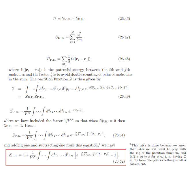

Taken from 'Concepts in Thermal Physics':
For the step highlighted in red, why does the '-1' go into the integrand?
