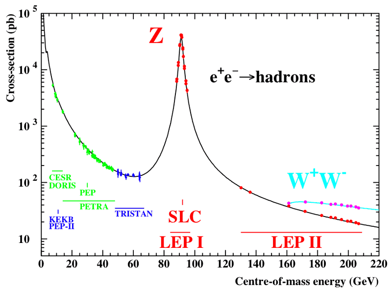

If you plot the cross section against the invariant mass, you get a spectrum that looks like this (from here):
You can compare this spectrum to "what would happen in a world without Z", and then assign the difference to the Z, but that is not really fair. You can also ask "what would happen in a world without the photon". And here is the point: If you add those two results, you do not get what we observe: it is not "either/or".

jeffbarrington said:
My question is that when we do the calculations, do we still include the contributions from those diagrams which include the Z when the CM energy is less than the mass of the Z (I am fairly sure we do, just checking) and, if this is the case, do these contributions become smaller?
It is relevant below 90 GeV (as you can see from the plot above, it is a significant contribution starting at about 70 GeV), but the contribution in general gets smaller if you are further away from 90 GeV.
