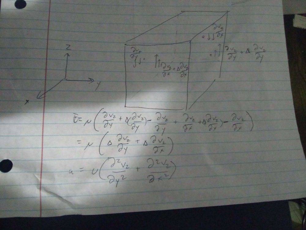

I'm a bit confused about the viscosity term in the Navier-Stokes equation; my intuitive understanding of what it would is different from what it actually is.
I took the z component of the stress on an infinitesimal cube, but the same approach should apply in the x and y direction. I think my method might be a bit sloppy (maybe leading to the error), but I'm not sure how to be more precise. I end up missing the third term of the Laplacian, the second derivative of the z component of velocity with respect to z. What am I missing?
Thanks.
What you scribbled is unreadable.
On the left side of the cube, the shear is:
##-\mu \frac {\partial v_z} {\partial y}##
and on the right side of the cube, the shear is:
##\mu (\frac {\partial v_z} {\partial y}+\Delta \frac {\partial v_z}{\partial y})##Similarly, on the back, the shear is:
##-\mu \frac {\partial v_z} {\partial x}##
and on the front side, the shear is:
##\mu (\frac {\partial v_z} {\partial x}+\Delta \frac {\partial v_z}{\partial x})##
I then added up the shear stresses giving the following:
##\mu (\Delta \frac {\partial v_z}{\partial x}+\Delta \frac {\partial v_z}{\partial y})##
or:
##\mu ( \frac {\partial^2 v_z}{\partial x^2}dx+\frac {\partial^2 v_z}{\partial y^2} dy)##
I also know that:
##a=\frac{F}{m}=\frac{\tau dA}{\rho dV}##The differential lengths cancel, leaving me with:
##a=\nu(\frac{
\partial^2 v_z}{\partial x^2}+ \frac {\partial^2 v_z}{\partial y^2} )
This is not correct. The general equation for this shear stress according to the 3D version of the constitutive equation for a Newtonian fluid is $$\mu\left(\frac{\partial v_z}{\partial y}+\frac{\partial v_y}{\partial z}\right)$$

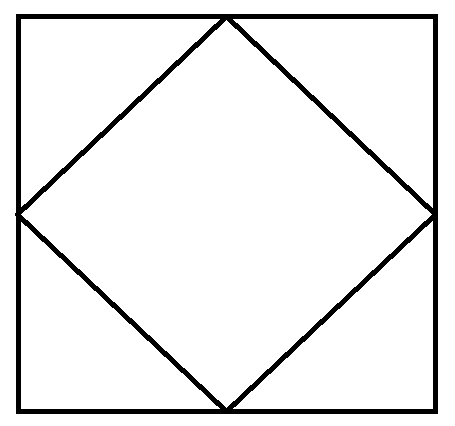

I came up with an explanation which I think makes sense but I'm not sure if it is correct. First I imagined a square within a square (as shown in the photo), and then I thought about the shear strain of the small square caused by the normal strain of the large square.
245110
I called the length of a side of the large square ##s##. $$\frac{d\epsilon}{dt}=\frac{1}{s}\frac{dy}{dt}=\frac{\partial v_y}{\partial y}$$ Because the fluid is incompressible, there would be the following strain in the x direction (assuming there is no strain in the z direction):$$\frac{1}{s}\frac{dy}{dt}=-\frac{\partial v_x}{\partial x}$$
I knew that the normal strain would produce a change in angle in the smaller square, and I derived the connection in the following way: $$\tan (\theta)=\frac {y}{x}$$ $$\frac{d \tan(\theta)}{dt}=\frac{dy}{dt}x^{-1}+y(-1)x^{-2}\frac{dx}{dt}=\frac{\partial v_y}{\partial y}+\frac{\partial v_y}{\partial y}=2\frac{\partial v_y}{\partial y}$$
And because:
$$\frac{d \tan(\theta)}{dt}=\frac{\partial v_x}{\partial y} +\frac{\partial v_y}{\partial x}$$
It must be true that: $$\frac{\partial v_x}{\partial y}+\frac{\partial v_y}{\partial x}=2\frac{\partial v_y}{\partial y}$$
This would then relate the normal strain in the large square to the shear strain in the small square.
