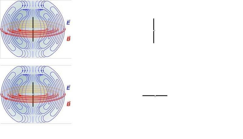

Hi Guys.
Thanks for the responses. I can visualise it much better now. I still have a bit of an issue with the received signal.
I have attached an image which has two parts.
I the first part (top half) the receive antenna will receive the transmitted signal (-free space path loss).
In the second part (bottom half) the antenna is rotated 90degrees. Will it receive the signal due to the electric field now being perpendicular to the antenna.
Thanks,
Mark.
no, because the transmit antenna and the receive antenna are cross-polarised and the receive antenna will pick up little to no signal
And if that receive antenna is end on to the transmit antenna, as hinted by your diagram, the transmit signal will be totally nulled.
This is the method of how we direction find a transmitter
the top image shows the 2 antennas with the same polarity and so maximum signal will be induced into the receive antenna
Dave
Hi Dave.
That's what I thought. But say for example you are lying down with your phone or the radio aerial is at a funny angle the signal is ok. How is this? Would it be that the signal is in fact weaker and that the device just up's the power?
Mark.
It's worth noting that there is no such thing as an isotropic radiator of EM (transverse) waves. There are always nulls in the radiation pattern. Easy to show this is true if you ask yourself what happens when you follow the field patterns around a simple dipole. At the ends, the tangential (i.e. the radiated) fields go to zero and no energy is radiated. You can't 'add in' another dipole to fill in for these fields without producing a null in another direction. The best radiator to consider, when trying to visualise things is the dipole, which it's the one dealt with in all textbooks. That is no cop-out. It's just being realistic.
In real life, there are antennae that will appear to be 'almost' omnidirectional but that will be due to the wide dynamic range of the receiver you are using and the effect of nearby objects which can easily produce radiation patterns which are different over the band (due to wave interference) and they can easily appear to be filling in the obvious nulls and also changing the plane of polarisation. In the end, though, it's analogous to a partially filled air mattress - you can push down on one bit but another bit will always pop up.
OTOH, for a longitudinal wave, it is easy to produce and visualise an omnidirectional radiator - a small, radially oscillating sphere will radiated equal pressure (sound) waves in all directions.
