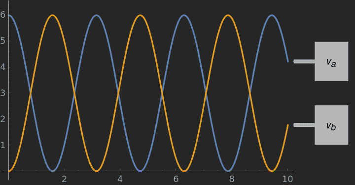

I have tried using Mathematica to plot the graphs, by fixing arbitrary but still reasonable values for ##v_0=6## and ##\omega=2##:
Graphs of the velocity:
Which shows simple harmonic motion as expected.

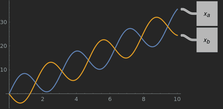

$$x_a = \frac{6}{2} (t + 2 \sin{2 t})$$
$$x_b = \frac{6}{2} (t - 2 \sin{2 t})$$
The displacement graph? (I got it by integrating the above equations of the velocity)
At leats it shows displacement towards the right, presumably more positive y.
Is this method correct? Obviously I am missing out on quite a few details: I am struggling to imagine the actual motion!

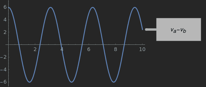

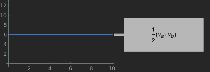

Life becomes a bit more transparent in this case if you look at ##v_a+v_b## and at ##v_a-v_b## :
You 'see' motion of the center of mass and the spring oscillation
