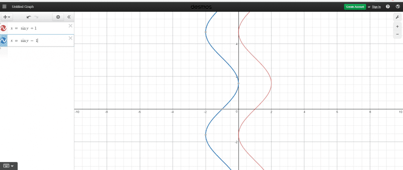

Hey guys.
So I've been trying to learn Double Integrals on my own and I'm at Volume between surfaces...so googling some worksheet problems I came across the one and I'm a bit confused.
1. Homework Statement
Let U be the solid above z = 0, below z = 4 − y^2, and between the surfaces x = siny − 1 and x = siny +1. Find the volume of U.
So what I was thinking was that the surfaces are x = siny − 1 and x = siny +1. Normally with the volume between surfaces you equate both of them and the resulting function is the region for which the volume is found between the region itself and the difference of the two functions...and the double integral is setup from this.
But here the surfaces are defined in terms of x so I was thinking that the surfaces are in the xy plane and below the 3D parabola in the Z plane z = 4-y^2. So is it the Volume between that and the region enclosed between the surfaces x = siny − 1 and x = siny +1?
My biggest issue in going forward is actually visualizing what's going on so I can setup the double integral

In your graphic of the two sine functions, plot the two lines ##y=2## and ##y=-2##. The area between those and the two sine curves is your xy domain. The height of your top surface is ##z = 4-y^2## so that is your integrand. Integrate it over your xy region. Do you see which order dxdy or dydx is preferred?
Sorry about the bolding...didn't know...just used the default layout.
Thanks btw. I slept over it and I was thinking to use the z=f(x,y) function as my integrating function as you said over the region bounded by the two curves.
But why use between y=2 & y=-2 though? I know that I have to have some definite values to integrate between but how did you come to the conclusion to use those y values.
BTW dxdy would be preferred since y=-2&2 are constants and they go on the outer integral.

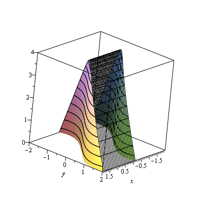

Ronaldo95163 said:
Ahh yes they do...the parabola closes down on the xy plane. That means I will be integrating f(x,y) over the region bounded by the two sine functions and the lines y=2 and y = -2 with the order of integration being dxdy
Yes. Here's a picture for your amusement:
Thanks a lot man!
What did you use to plot that btw?
Ronaldo95163 said:
Thanks a lot man!
Maple.
