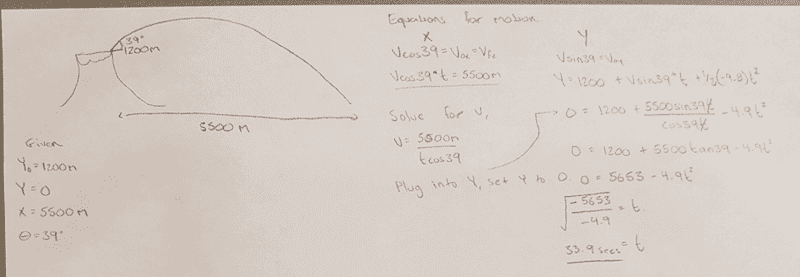

Hmmmm ok. I will rewrite this on paper and post back soon
Ok, I think this is good
Good. Now, for V?

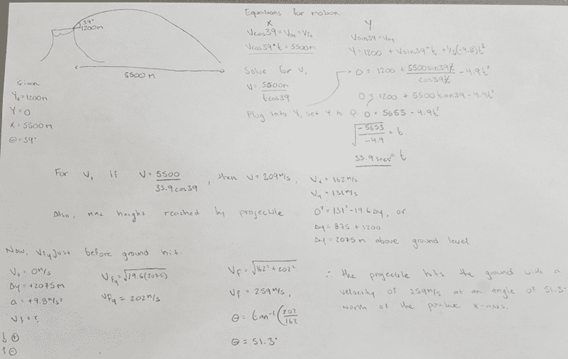

I solved for Vx, Vy, max height, and final velocity as well.
I really needed to solve this question.
I think it's all good.
That all looks right to me. Excellent!

Hi, could you explain how you got the max height and final velocity? I am taking this course as well and my exam is on Friday, I'm really nervous so any help will be appreciated!
@David89 How about you help this member?
Likes David89
Sure!
Once you get t, you can plug t into your equation for V to solve for your initial vertical velocity.
Once you have initial vertical velocity, you can resolve your vector into horizontal and vertical components, and you can set the final velocity for vertical motion to zero (since Vf is zero when the projectile is at its highest point), and solve for delta y using Vf^2 = Vo^2 + 2a(deltay), since you now have the 3 variables needed to solve for the kinematic.
For the final velocity, I resolved the x-component and the y-component seperately (x remains constant while y, starting from your max height, gets faster and faster until it finally hits the ground) and then used the pythagorean theorem to get Vf, and arctan(Vy/Vx) to get the final angle.
Hope this helps.
