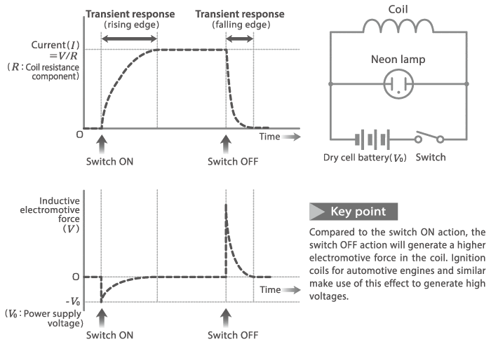

The voltage across an inductor is described by the equation: ##V(t) = L\frac{di(t)}{dt}##
For the case where current is flowing through the inductor until ##t=0##, at which point the voltage/current supply is switched off, the voltage then takes the form: ##V(t) = L\frac{de^{\frac{-t}{\tau}}}{dt} = -L{\tau}^{-1}e^{\frac{-t}{\tau}}##
My question is, why is this voltage negative? Wouldn't that oppose the current flow? Obviously I'm not understanding something, as this appears to contradict the fact that an inductor opposes changes in current. I thought the voltage would be a positive number, so as to continue current flow in its current direction.

Can you show a circuit where you see the voltage supply being "switched off"? Often in basic circuit analysis of inductor circuits, a switch will be shown to open circuit the connection to the source supply. In those cases, you can get very large voltage transients, limited only by the parasitic capacitance of the circuit. (Or the explicit capacitance in circuits like flyback transformers for generating high voltages).
http://www.global.tdk.com/techmag/electronics_primer/img/img_electronics_primer_inductor_vol2_1.gif
Sorry Berk, that's what I meant. I didn't know quite how to word it though.
