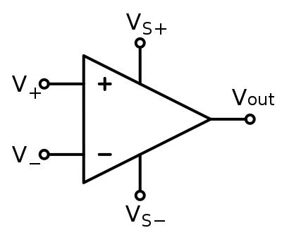

Ok. Thanks. Just for knowledge: if current is going into the output of the opamp, then where does it go from there? Like current needs a closed path.
So if current enters opamp from output, where does it come out from?
Or if current is coming out from output of opamp, how does it enter the opamp?
The op amp has connections to the power supplies, as shown in this figure. They source or sink the output current.
Likes jaus tail
