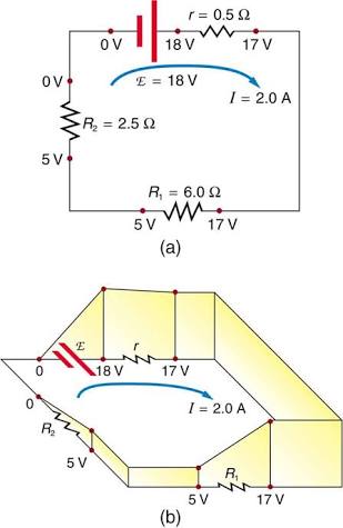

Luke0034 said:
so the total voltage adds up to 75 volts, BUT WHY?
This is Kirchhoff's voltage law. The sum of potential drops in a loop should be equal to the sum of potential gains in that loop, which means the total of potential changes should be zero in a loop.
Think about it. If this weren't true, where would the extra volts go?
See if this picture helps.
Likes davenn

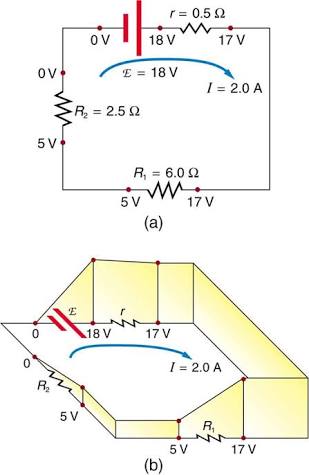

cnh1995 said:
It would be better if you wrote current=voltage/resistance. You apply voltage, current is decided by the resistance of the circuit. Naturally, more resistance means less current and the voltage drops should add up to the supply voltage.
See if this picture helps.View attachment 114149

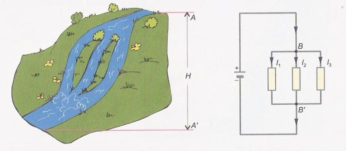

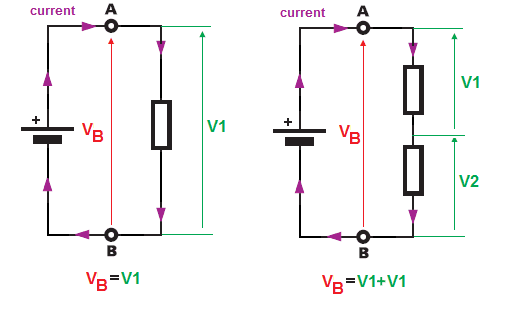

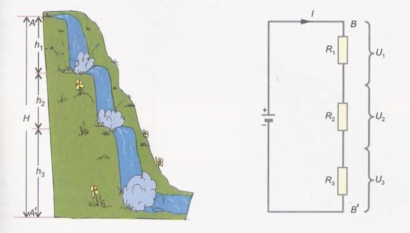

I think that you should start to use "black box" approach. Don't go too deep into the subject.
In the first circuit, we have one voltage source and one resistor. This one resistor is connected directly across the voltage source terminals ( two terminals A and B).
From point B to A the voltage is equal to VB and the resistor is also connected between point B and A, So the resistor will also see the same voltage across his terminals and this is why Vb = V1 (Vbattery = the voltage across resistor).
For the second case, we have one voltage source, but this time we have two resistors connected in series.
And again the voltage Vab = Vb. And notice that this two resistors are connected between terminal A and B, so the sum of V1 and V2 must be equal to VB.And some water analogy
And some water analogy for parallel connection.
Notice that this time all resistor will see the same voltage (VB)
Likes malemdk and cnh1995
