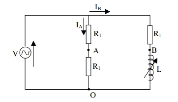

In a parallel circuit, one branch contains two equal resistors of resistance ##R_1## connected in series. The other branch contains a resistor of resistance ##R_1## in series with an inductor of variable inductance ##L##.
Show that the magnitude ##|V_{AB}|=\frac{V}{2}## and ##\phi=\tan^{-1}\big(-\frac{2\omega LR_1}{R_1^2-\omega^2L^2}\big)##https://gyazo.com/50cbf5ef913b0fc533ebcb0074b3b5a3 (Very sorry for the link, but the image uploader wasn't working for me)
{image inserted by moderator}I have worked out that total impedance =##|Z|=\frac{2R_1(R_1+\omega L)}{3R_1+\omega L}## Which I'm not sure is correct.
I'm thinking that I have to work out what fraction of voltage ##R_1## gets in the ##B## branch, but I'm pretty confused.
Edit: I have managed to prove ##|V_{AB}|=\frac{V}{2}## and am now stuck on the second part, it's only two marks so it shouldn't be difficult, I just don't know what impedance I'm meant to be taking
Any help on this would be really appreciated :)

For the phase angle, you've probably done most of the work already when proving that ##|V_{AB}|=\frac{V}{2}##. Can you show that work up to the point where you found the magnitude?

Well it might be a bit of a jump, but I said for A it was V/2 as the voltage simply splits 50/50. Then for B I said as the impedance between the resistor and the inductor is pi/2 out of phase, therefore voltage across the resistor varies between V and 0... and I just called it 0.
I'm afraid that doesn't hold water as a derivation. You'll need to return to that part and do the math.
The A branch is a simple voltage divider as you pointed out. But so is the B branch. The only difference is that one of the elements is an inductor rather than another resistor. You should be able write an expression for the potential at point B using the voltage divider formula.

The part which confused me was that the voltage from A is already V/2, therefore B has to be 0, which means surely the circuit wouldn't work?
That's not correct. Branch B contains an inductor. You need to consider the phase difference between voltages at A and B.
Following on to what @cnh1995 said, if you do the algebra you'll find the answers to both the voltage magnitude and the phase angle questions.

Do the math; it's just a bit of complex algebra. It'll automatically take care of the phase relationships without your having to make guesses. Certainly when the circuits get more complicated you won't be able to use handwavy arguments to analyze them.

I think my problem is setting up the correct math, it's confusing to me what to do, could you help with that please?
Look up: "voltage divider" (or "potential divider").

Would you be comfortable with the phasor approach?
Yeah I am, many thanks
Ok.
Can you develop the phasor diagram?
Take the inductor voltage as reference phasor.
cnh1995 said:
Ok.
I think taking supply voltage as reference phasor would be the right approach.
