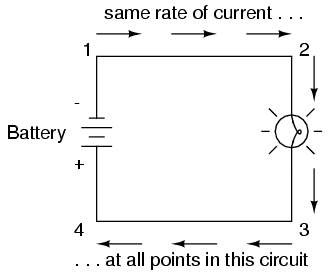

Why is the voltage between two points on a wire in a closed circuit equal to zero? Note that between these two points there is no resistance; Think about it as a wire with no other electric devices attached in between these two points.
Here is an illustration of what I mean: (taken from allaboutcircuits.com)
My question is, why is the voltage between 1 and 2 (or, 3 and 4) zero, but that of 2 and 3 not? I can't understand how these two have different voltages.
Here is what I understand:
  • The current in the whole circuit is affected by the resistance of the lamp, because the potential energy of the battery is trying to "push" electrons with a certain amount of force per unit charge, but the resistance of the lamp will make this push "slower". Think about electrons in the circuit as marbles arrayed along the wire. At any point, if there is a resistance, the whole "push" of electrons (i.e. marbles) in the whole circuit will be "slowed". That results in a lower current (i.e. the whole array of marbles which spans the wire will be slowed in movement).
  • Voltage is the measure of electric potential energy per unit charge (Columb). It is a result of imbalance of electrons (one matter has an excess of electrons from another matter which now has a deficiency of electrons-that's why it measured between two points). This imbalance creates that electric potential energy, which is "actualized" in the form of a force pushing electrons back to their original matter to balance the excess/deficiency.

Considering the wires to be ideal (zero resistance), the electrons need no energy to maintain their motion through the wire. But the lamp has a resistance and hence, some energy is required to maintain the current through the bulb. So all the voltage appears across the bulb.
This explanation may not be accurate, but I think it will give you a basic idea about voltage drop.

Voltage V= energy/unit charge=W/q.
To move a charge from point a to point b, the electrostatic potential energy needed by the charge can be written as W=q*Vab.
As you can see, this energy is proportional to the potential difference between a and b.
In your circuit, this energy is zero for ideal wires, hence no voltage appears across the wires. All the voltage appears across the bulb. Because of the resistance of the bulb, electrons in the bulb filament require more electrostatic potential energy to maintain the same current as through the ideal conductors. Hence all the voltage appears across the bulb.

Why is the potential energy zero for an ideal wire (in a closed circuit, which has running electrons)?
Because there is no resistance. Imagine a ball rolling on an infinitely long frictionless surface. It will continue to roll with the same velocity forever. But if the surface had friction, it would stop after a while. So if you still want the ball to move with the same speed, you need to apply a force which is equal and opposite to the friction. You need force to "overcome" the friction. Similarly, you need voltage (electric field precisely) to overcome electrical resistance. You can think of voltage as an electrical analogy of mechanical force.

Because one definition of 'ideal wire' is the zero voltage drop regardless of the current?
Kinda' first rule of the Tautology club...
The 'same' here means: the same current which flows through the loop, and not the 'same as it would be with ideal wire instead'.

The literal answer might be a bit disappointing. It's because we engineers are lazy, so when the resistance of the wires does not effects the results we tend to replace them with 'ideal wires' to spare some time with the calculations.
And one definition of the 'ideal wires' is that regardless the current they has no voltage difference between any two points of them.

Temp - I really think your hang up here is the "ideal" vs "real" --- in ALL real cases there is a voltage drop if there is any current. The purpose of using an ideal model is this Wire Voltage drop tends to be much lower ( factor of 100 or greater) than the voltages applied or drop(s) by the other circuit elements, or even the variance of the values of the other elements. For example a typical resistor will have 2 to 10% variation, there are higher precision ones, 6V battery has an internal resistance, and the bulb - the 3W is probably more like the Upper limit for the product, and the variation is close to 2.6W to 3.0W
However for most circuits delivering power or considerable current, the V drop in the wire is considered - like jumper cables, or household wiring, and this affects the correct or best choice for the size of the wire used.
In your circuit case you could have 6 V battery and small 3 Watt lamp, in fact this would be a very common early experiment. In this case the bulb when on, will use 3W/6V = 0.5 Amps of current - note the bulbs resistance increases dramatically as it is turned on, so when on ( @ 6V) the bulb has a resistance of V/I = 6V / 0.5A = 12 Ohms.
Use something silly small for the wire, like 30 ga wire, you have 0.103 Ohms resistance ( real) per foot of wire. In the circuit above ~ 1% of the total resistance if added to the lamp.
Typical lab hook up wire, like you would use for the circuit above, like 20 Ga solid copper, the resistance drops to 0.099 Ohms per foot ( 0.1%) . Something unnecessarily large - 10 Gauge 0.0099 Ohms per foot - 0r ~ 0.01% - one part in 10,000.

Is this thinking valid:
Across the wire, there is no imbalance of electrons, and therefore there is no electric potential energy, and thus no voltage.
But now the question is, why is there a voltage across the lamp? Is there an imbalance of electrons at each pole of the lamp? (I think not!)

If you are interested in the exact mechanism of electrical conduction, look up 'surface charge feedback mechanism'. There's plenty of material available on the internet. (Refer 'Matter and Interactions' or D.J. Griffiths if you want to study from books) It will tell you why and how the voltages develop across the circuit elements (charge imbalance gives rise to surface charges on the components).
For energy transfer process, look up 'Poynting vector'. These two theories will answer most of your questions.

I think your trouble stems from definitions. I don't think your definition of voltage is correct.
This is close but not quite right
That's it's units allright
but it's actually a simpler concept than that.
And Rive is right, when we lazy engineers get accustomed to using it we broad brush past the details.
Here's how to think about it
Voltage is Potential Difference. Two words, not one. Difference is the easy one.
So what's potential?
Potential is the work required to bring a unit positive charge from infinity to wherever you're measuring potential.
[PLAIN said:
https://www.merriam-webster.com/dictionary/potential][/PLAIN] b : the work required to move a unit positive charge from a reference point (as at infinity) to a point in question
That takes some thought.
Imagine yourself at Alpha Centauri(close enough to infinity for demonstration purposes)
with a one Coulomb sized bucket full of charge,
a force gage, and a ruler.
I grew up with dynes and centimeters but Newtons and Meters are easier...
Now start walking toward earth, measuring the force in Newtons exerted on your bucket of charges and tabulating it at every meter along the way.
So as you move toward Earth you're going to tabulate the Newton-meters and keep a running sum.
The reason for this is that no energy is expended in getting charges from one end to the other of an ideal wire. The energy that's expended in a load can be described in terms of the Potential Difference between the two terminals. That's how Volts (PD) are defined. Getting into the harder business of detailed descriptions of mechanisms is probably more than the OP wanted.

Keeping things simple, the resistance of the wire between points 1,2 or 3,4 is zero (in the ideal case) volts because the resistance is very small very small. The resistance will depending on the IR drop of the wire between those pairs of points. The farther
apart they are, the greater the IR drop. Electron flow decreases reducing the current with a increases IR drop. If you were to put a voltmeter lead at point 1 and the other at point 2 it would show zero voltage if the points are very close because there is no significant resistance to generate a potential difference. If the points move apart with the wire still connected the voltmeter will begin reading a potential difference. Sometimes it helps to get a non theoretical point of view. Hope this helps
Let me take a swing at this one. Like the OP, I'm not a physicist; I'm a mechanic and electrical hobbyist.
Assuming an ideal wire, which is what your original post seemed to stipulate, there is no "between 1 and 2" from an electrical standpoint. 1, 2, and the positive terminal of the battery are all the same thing. Same goes for three, four, and the negative terminal.
Voltage (as Jim explained) is a difference in electrical potential between two points. There is a greater concentration of electrons at the negative terminal of the battery, so when there's a pathway to the positive, electrons flow along the conductor until the "pressures" equalize (and yes I know that's not a correct application of the word "pressure"). Now, if the wires are ideal, there is no difference in potential between the positive terminal, point 1, or point 2 (vice versa for negative/3/4) since they're connected directly to each other. When you connect the lamp, one side of it will be connected to the positive/1/2 point of potential and the other will be connected to the negative/3/4 point. The voltage of the battery across the lamp will then induce the current determined by V=IR
In a real-world application, there will be a very small amount of voltage drop depending on the gauge of the wire.
But now the question is, why is there a voltage across the lamp? Is there an imbalance of electrons...?
― excatly! That's the very thing.
A wire is a piece of metal where electrons are (almost) in equilibrium ― even when conducting what seems to be a strong current.
A hot filament (with the same current) of a lamp is a piece of metal where electrons are very far from equilibrium, because of different metal structure that is unable to conduct current without much irreversible energy dissipation.
(By "electrons" I mean the whole free electron system of entire piece of metal.)
The difference is like that of a calm sea and a river with many noisy waterfalls.

So in your diagram you posted at the start
you put the negative probe of your meter on 1 (A) and the positive of your meter on 2 (B) and you measure the voltage drop between those points
you could then put the negative probe of your meter on 2 (B) and the positive of your meter on 3 (C) and you measure the voltage drop between those points in this case across the globe)
voltage needs (must) to be measured between TWO points. You CANNOT say that the voltage at point 1 or 2 or 3 or 4 is xx volts without it being referenced to somewhere else in the circuit
Also a way back you couldn't understand why you couldn't measure a voltage between 1 and 2
if as stated it is an ideal wire ( no resistance) then the voltage (PD) measured between those 2 points will be zero ... why ?
V = I x R
V = let's say 2 Amps x 0 R
2 x 0 = 0 therefore V = 0 (zero)
real world, that length of wire will have a resistance depending on its length and conductor size and as a result there will be a small measurable voltage drop
