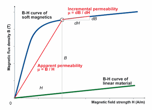

Your 410 volts is more than the motor's rated 380 by about 8%.
Which means you're driving its magnetic flux higher, nearer saturation
so it draws a bit more magnetizing current.
That's because of the ubiquitous B-H curve
from http://www.coolmagnetman.com/magfund07.htm
Since this plot has no numbers on it, we can say it's effectively amps horizontal & volts vertical
Flux will be in proportion to voltage
and once you're out past the knee it takes quite a bit more magnetizing current to push flux higher..

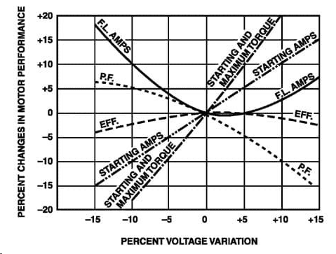

I thought that the effect of the increment of the voltage over the magnetizing current was minor than I measured, but I understand, from your explanation, that the motor is going into saturation.Can we relate the effect of the voltage increment / current increment with the decrement of the power factor in the graph?
I can't measure the machine with 380 V (motor's nominal voltage): the present line voltage is, more or less, 400 V. From the measurement (1.60 A @ 410 V and 1.35 A @ 400V) would you tell (estimate) that the motor is not working at full load? (Working at full load, at nominal voltage 380 V, I would expect measure 1.5 A as per plate).

I would estimate that as you suspect it's lightly loaded.
I say that because your current drops below nameplate between 5% and 8% overvoltage
Is my arithmetic right -
dividing your readings by nameplate values
at 7.9% overvoltage you have 6.7% overcurrent
and at 5.2% overvoltage you have 10%undercurrent
Is that motor running pretty hot to the touch ? Its iron is being worked fairly hard because of the overvoltage.
