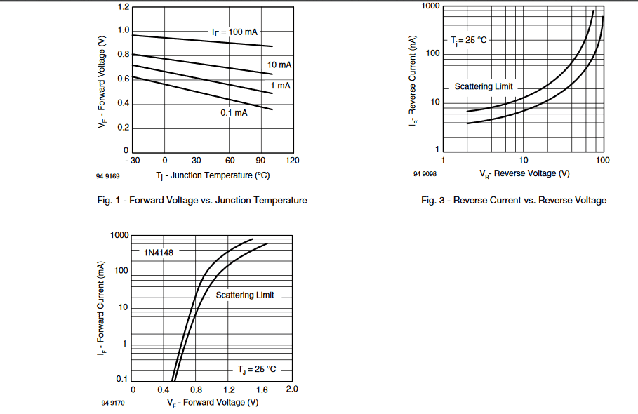

My understanding of those data sheets is that voltage and current are dependent on each other. However, why was I taught in class to treat the voltage drop of a diode as a constant 0.7V (for silicon)?
Only at around room temperature and at a few mA of forward current. That's a fine way of thinking for the first introductory class in circuits. But that's not how diodes work in the real world. For real world circuits (or when you have a problem posed with nose-to-nose diodes), you will need to use the diode equation with reasonable values for Is from datasheets to help you figure the circuit out, IMO.

Sorry that I'm late to the thread, but are you supposed to assume ideal or real diodes for this schoolwork problem? That is something that needs to 1N4148be part of the problem statement, since the answers will be different.
If you need to use real diode models (like the small 1N4148 diode) then use the datasheet to find a realistic Is value for the diode equation. If the diodes are supposed to be ideal, what is your answer then?
So then my final answer would be V(D1) = 18mV, V(D2) = 4.974V and I = 0.998 nA.
Would these be reasonable values for my final answer?
