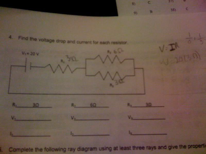

heres a picture of the problem. Please don't give me the answer just tell me what are the steps to complete it. thanks.
http://i307.photobucket.com/albums/nn296/alan1592/download-1.jpg
V=IR
1/6+1/3=2 Ohms
Ok, so you now have two resistors in the circuit- you can calculate the voltage drop across each resistor and, using Ohm's law, the current. You need to be a little more specific with what you're looking for so you can get more help.
Im looking to find those items. The voltage drop and the current. I don't know how.
Since there is one indepedent voltage source of 20 Volts that means the voltage drop across all the resistors should equal 20V.

First Combine the Resistors in Parrallel:
1/R =(1/R_1)+(1/R_2)+...(1/R_N)
1/R = (1/6 Ohm) +(1/3 Ohm)
1/R = (1/6 Ohm) + (2/6 Ohm)
1/R = (3/6 Ohm) = (1/2 Ohm)
1/(1/2 Ohm) = R = 2 Ohm
So now you have
|___________________|
Sorry for the bad drawing
( --||-- = voltage source, ^^^^ = resistor)
Now combine the resistors in series
R= R_1 +R_2+...R_N
R= 3 Ohm + 2 Ohm
R = 5 Ohm
So now you have
|____________|
Using V = IR you can solve for the current:
V=IR
(20 Volts) = I * (5 Ohm)
I = 4 Amperes
Now split the circuit back up so that it is 2 resistor in series.
Resistors in series have the same current
So for the first resistor (3 Ohm resistor)
V = IR
I = 4 Ampere
R = 3 Ohms
V = (4 Ampere)(3 Ohm)
V= 12 Volts
Voltage on the 3 Ohm resistor directly right of the independent voltage source is 12 volts
Now for the second resistor (2 Ohm Resistor)
V = IR
I = 4 Ampere
R = 2 Ohms
V = (4 Ampere)(2 Ohms)
V = 8 Volts
Voltage on the 2 Ohm resistor directly right of the 3 Ohm resistor is 8 volts.
Split it up so you are back with the circuit you were first with.
|___________|----^^^^--|
Resistors in parrallel have the same voltage so:
6 Ohm Resistor in Parrallel:
V=IR
(8 volts) = I * (6 Ohm)
I = (4/3) Amperes
3 Ohm Resistor In parrallel:
V= IR
(8 Volts) = I * ( 3 Ohm)
I = (8/3) Ampere
So,
Resistor 1:
Resistor(R)= 3 Ohm
Voltage Drop(V) = 12 Volts
Current(i) = 4 Amperes
Resistor 2:
Resistor(R) = 6 Ohm
Voltage Drop(V) = 8 Volts
Current(i) = (4/3) Ampere
Resistor 3:
Resistor(R) = 3 Ohm
Current(i) = (8/3) Ampere
