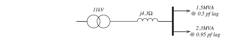

Voltdrop calculations are made as shown below.
Total loadLine currentI=1.5/−60∘⎯⎯⎯⎯⎯⎯⎯⎯⎯⎯⎯⎯+2.3/−18∘⎯⎯⎯⎯⎯⎯⎯⎯⎯⎯⎯⎯
=(0.75−j1.3)+(2.19−j0.71) <<< (How to get to these numbers only from above??)
=(2.94−j2.01
)=3.56/−34.4∘⎯⎯⎯⎯⎯⎯⎯⎯⎯⎯⎯⎯⎯⎯⎯MVA
=(2.94−j2.01
Welcome to PF!
Post this question in the homework help forum with the three-part template provided.
