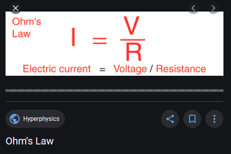

AdrianRodz1 said:
I believe the answer was in my reply, was it not? "100V"
Likes Joshy
Likes davenn and phinds
