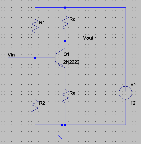

My professor asked me to provide a circuit design for a voltage divider biasing circuit whereby the transistor beta is independent of the voltage gain, which he wants to be -100.
I maintain this is impossible, as Ic = B*Ib, changing the beta obviously effects the gain.
Right?
(not asking for the cct)
I have notes on how, we can make the voltage divider behave as a constant voltage supply - by making the current through the divider resistors large in comparison to Ib.
This makes sense, but still, if we change the transistor and beta, then Ib is amplified by a new beta, this effects Ic and all the voltages across the transistor (C to E), the collector resistor, and so on...
He maintains that I1 = I2+Ib
Vbb = Vcc - I1*R1 = Vcc - (Ib+I2)*R1
So, Vbb is dependent on Ib, which we do not want
So we make Ib very small, and Vbb is approx. equal to Vcc - I2*R1
If beta is much larger than 1, Ic is approx equal to B*Ie equal to B*Ic
Vbb - Vbe - Ic*Re = 0
Ic = Vbb - Vbe divided Re.
Now Ic is independent of Beta.
Can some one explain how Ic is independent of beta? it simply doesn't make sense.

To a first order the gain of a common emitter amplifier is Rc/Re. Changes in beta will have small effects for small signal applications. (for example a different drop across Rb due to change in Ib)
I have designed a circuit and the calculated gain is -100.
But Rc/Re is only about 4 or 5
it is common emitter, voltage divider biased.
On paper, it works great. different transistors don't effect the gain because Ib is very small, and Vbb is approx. constant.
So as beta doubles, Ib = Vbb - 0.7/ (1+b)*Re approx. halves. But that keeps Ic the same.
On paper it works, but then I ran it through spice and got some distortion for the requries 0.02v input.
works fine for 0.002v input, I get that proper -100 gain, and a swing between almost exactly -0.2 and +0.2 volts

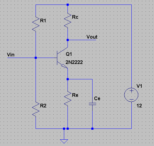

Let my try to clarify some confusion that arise here about CE stage voltage gain.
First this circuit.
Ce capacitor shorts Re resistor for the AC signal. So we have no negative feedback anymore for AC signal.
And the voltage gain of this stage is equal to
[itex]\Large\frac{Vout}{Vin} = -gm*Rc *\frac{\beta}{\beta +1} = -\frac{Rc *\beta}{re *(\beta+1)}\approx-\frac{R_C}{re}[/itex]
where re is equally to
[itex]\Large re = \frac{Vt}{Ie} = \frac{\beta}{gm(\beta+1)} \approx \frac{1}{gm} \approx \frac{26mV}{Ic}[/itex]Now if we remove Ce capacitor from the circuit
The voltage gain will now be equal to
[itex]\Large \frac{Vout}{Vin} = -\frac{Rc}{re + Re} *\frac{\beta}{(\beta+1)} \approx-\frac{R_C}{(re + R_E)}\approx -\frac{R_C}{R_E}[/itex]Ss you can see beta would in fact effect the gain by the factor of β/(β + 1).
For the Av = 100 and β = 500 we have
A = 100*500/501 = 99.8V/V
But if we have a BJT with β = 20 the voltage gain will drop also but not much.
A = 100 * 20/21 = 95.24V/V
Also high beta BJT will have a smaller ro = dVce/dIc = (Va - Vce)/Ic value. So this will also affect the gain.
Va = Early voltage

Jony shouldn't Vo = -Beta*ib*Rc in your circuit?
And Vo/Vs = -gm*Rc ? I am not sure where B+1 is coming from in the denominator, as Re is shorted? also the Beta in the numerator. I had one there initially, but it was used to express gm as gm = Beta/Rpi
Yes you right, I made a simply error in the voltage gain equation.
The voltage gain for CE amplifier with Ce capacitor is of-course equal to
[itex]\Large Av = \frac{Vout}{Vin} = - gm*Rc = -\frac{Rc}{re} * \frac{\beta}{(\beta+1)}\approx -\frac{Rc}{re}[/itex]
This betas in equation is here because of a re - small signal resistance beetwen base and emitter looking into the emitter
re = dVbe/dIe = Vt/Ie ≈ 26mV/Ic
and since gm = Ic/Vt
and Ic = alpha*Ie = (β/(β + 1))*Ie we get
gm = Ic/Vt = Ic/Ie * Ie/Vt = Ic/Ie * 1/re = β/(β+1)*1/re

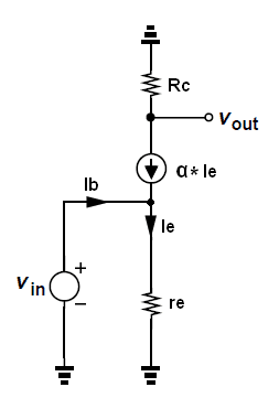

Also we can use small-signal T model to find out the voltage gain.
So we have
Vout = - alpha*Ie*Rc and Vin = Ie*re
So next we have
Av = Vout/Vin = (- alpha*Ie*Rc)/(Ie*re) = Rc/re * alpha = Rc/re * β/(β + 1) ≈Rc/re Also notice that some professors use Rpi = dVbe/dIb instead of re.
Rpi = (β + 1)*re
Av = (β*Rc)/Rpi = (β*Rc)/( (β + 1)*re) = Rc/re * β/(β + 1) looks familiar ?
But as you can see re gives simpler equation and better inside.
