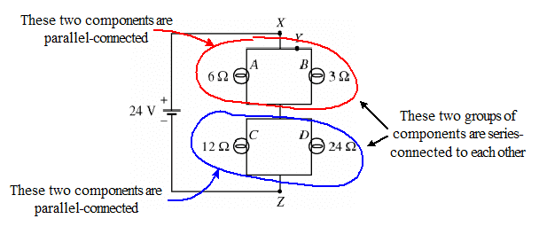

Calculate the magnitude of the current through point Y.
Ohm's Law: V=IR
Kirchoff's Junction: 1/Req=1/R+1/R2+1/R3+...
I have been told that in parallel circuits the voltage remains the same therefore I should have 24= IRB
Rb= 3 ohms so 24/3= 8 A. However this is wrong because this problem is from AP Physics B 2012 FR. They actually had to find the total current by finding the voltage of the AB component... But why are we finding this voltage? Like I said I have been told voltage is constant throughout the entire circuit...

No, your understanding of the relationship for voltage and parallel components is not correct. The rule is that components that are in parallel share the same potential difference across them.
In your circuit if you were to take a voltmeter and measure the potential difference across the 6 Ω lightbulb and then the 3 Ω lightbulb, you would read the same value for each. Similarly, you would read identical values for voltage across the 12 Ω and 24 Ω bulbs. But this would be a different voltage than for the other pair.
This circuit is NOT a parallel circuit, it is a series circuit with two sub-circuits that have parallel elements. For the voltage to be the same "throughout", you have to have all parallel elements. I suggest you go back and study what parallel and series mean.

Voltage is constant across parallel resistors, but AB are serially connected to CD.
Calculate RAB = RA || RB and RCD = RC || RD.
The total current through the circuit will be Itot = 24V / ( RAB + RCD ), hence the voltage across RAB, VAB = Itot * RAB.
The current IB = VAB / RB.
Sketch the circuit step by step, following the above.
The voltage from X to Z is the voltage of the power supply. Between X and Z are two sub-circuits in series, each of which has to parallel elements.
