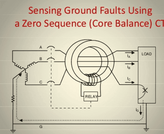

Is it this kind of system?
https://zone4engineer.com/public/album_photo/4c/08/708a0e3b1be0670b10eb3fa0e01c30b8.PNG

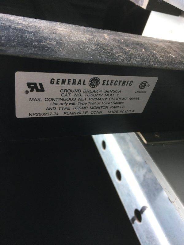

Yes. The manufacturer literature says to short “c” and “m” to prevent shock. It’s a 3 wire zero sequence CT for ground fault protection. The current from the CT energizes the trip coil. I’m just having a hard time reporting his 130v @ 400a to the customer because it seems wrong. The CT is a GE ground-break CAT: TGS0719 MOD 1
A Current Transformer should never be operated without a burden that will limit the voltage. The output of a CT is a current, not a voltage. The resistive burden converts the current to a voltage.
What burden was used during the 400 amp test that developed 130 volt ? Maybe there was an internal gas discharge limiter that prevented breakdown of the CT insulation.

In the photo one can find some data: "max continuous net primary current 3000 A.
That should be rated primary current of the CT as well.
In the installation instruction pdf the relay output rating is given as 5 A.
That should be CT rated secondary current as well.
Accordingly the CT ratio should be 3000:5 A
