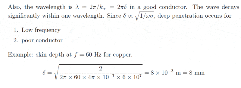

The point is that the wavelength *IN THE MEDIUM* is 1 skin depth.
So, the wavelength of 60Hz IN COPPER is ~8mm.
From http://fermi.la.asu.edu/w9cf/skin/skin.html :
"Except for the various factors of 2i and 2$\pi$ , the skin depth is essentially the wave length in the metal. The main thing to notice are that the free space wave length is enormously larger than the skin depth. "
This ties into Baluncore's assertion that the center of the copper wire can be multiple wavelengths delayed from the surface. If you look at the fields picture at the beginning of the article you see how the fields (and therefore the currents) change direction as you descend into the wire. If you look at the wikipedia eddy current loops picture, you see the complex currents associated with this from a 3D perspective.
The skin depth is the wavelength, but at the phase velocity in the conductive medium. That is why the concept of refractive index is so important.
