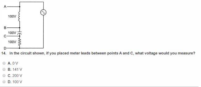

Hello I am a newby to electronics taking a class. Please review my thinking on this problem. I have a series LCR circuit with 100V given for each of the LCR components and I am ask to measure the AC voltage between points that include the L & C only. I say the answer is A because these are reactive components that take and give back energy from the circuit so no voltage drop across the 2- L & C. Please let me know yours thoughts- thanks

You need to consider the phase of the voltages you are adding. Let's assume an AC current through the network, which for the series circuit will be the same everywhere. Now can you decide the phase of the voltage developed across C and then across L relative to the phase of the current? Then you need to add these together graphically.

Not true. Their net energy over a complete cycle is zero because the current is 90 degrees out of phase with the voltage across them; not that the voltage is zero.
What do you calculate is the complex current in that loop?

This is being made more difficult than it needs to be. Series circuit, current is the same in L, C, and R. The same voltage across all three individual components. This means that the L and C have equal and opposite reactances. In other words they form a series resonant circuit. Voltage across a series resonant circuit is zero.

I don't think so
Voltage across the RLC series resonant circuit is obviously the excitation voltage.

It is given by the problem (not explicitly stated in the problem statement but it writes them in the schematic, i might interpret wrongly the schematic) that $$V_{AB}=V_{BC}=V_{CD}=100V$$

Yes that's right. But the voltage across R is meaningless for answering the question which is the voltmeter reading between A and C. ## V_R = 100 ## just means that the excitation voltage is 100V.
Yes the voltage across R is irrelevant for answering the question.
@Averagesupernova probably refers to the "resonant circuit" as the one containing only the L and C, but you refer to it containing R too, so I guess that's where you disagree with @Averagesupernova explanation?

Wow. Quite a misinterpretation of my post. Not sure I can state it any simpler. It's a given that all three components have the same voltage across them individually. Sure it makes no difference that we don't need to know the voltage across R but nonetheless it is there. No one argued my point about the current being the same in all three components so I guess we can assume to be in agreement there. The voltage across RLC is also given as a source voltage and I never said it was zero. To me, when picking a circuit apart as I did in my previous post a series resonant circuit is the L and the C, that's it, nothing more. Is it just me or has this been a nitpicking-fest?

Well, @rude man made a mistake in reading the problem's data, which he admitted so all good.
However I think he made a successful comment, by saying that the voltage across the series RLC resonant circuit equals the excitation voltage, that is the voltage across the ohmic resistance of the circuit. Resonant circuits have to have some ohmic resistance as well, because if we have a resonant circuit consisting of LC only and we have it connected it to an ideal (of zero internal impedance) voltage source, then the current will be infinite and the voltage across the resonant circuit will not be zero but will equal the source voltage.
