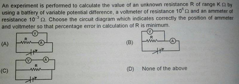

I am not able to understand how percentage
error in R is calculated using the given circuits.
Should I assign currents in the branches and write KVL equations ?

I think I can see the answer by inspection, but I'd still do a couple of calculations to verify my assumptions.
Start with R = 1kOhm. Then yes, calculate the delta-R caused by the finite impedances of the Voltmeter and Ammeter in each circuit. Then maybe verify it with R = 10kOhm to be sure.
Also, one of the circuits can probably be eliminated right away by inspection. Can you say which one and why?

It means you need to find the arrangement that gives most accuate value for R.
As berkeman said, one of the three options can be eliminated by inspection.

What exactly is ΔR ? Is it the difference between the resistance R and the net resistance across the battery ?

How is R measured in these circuits ?
I don't think the battery's internal resistance is part of this question. It was not mentioned in the problem statement.
Delta-R is the change in the measured resistance from what R really is. So for example, you already know that you could get a measured R = 1kOhm + 10^-3 Ohms if you measure both the resistor R and the Ammeter in series...

I might not be explaining myself well . A voltmeter measures voltage and an ammeter measures current .
How is R being measured ? What is causing a change in the actual value of R ?
Ideally, the voltage across R should be equal to the battery voltage. So the ratio V/I (measured using the meters) should give you the value of R.
However, real meters introduce their own resistances in the circuit and you get a slightly different value of R.
Likes Jahnavi and berkeman

Without actually using any given data , Is it option C) ? Because voltmeter reading V will be nearly equal to the battery voltage but Ammeter reading will be very less as compared to what it should be . The ratio V/I will give a very high value of resistance . Error would be quite high .Is it correct ?
So it is between options a) and b) ?

In a) voltmeter reading would be equal to the battery voltage but current would be little less .Ammeter reading would be less than what it should be . Calculated value of R is more than the actual value .
In b) , the voltmeter reading would be less than the battery voltage , but Ammeter reading would be nearly equal to what it should be . V/I ratio would be less than what it should be . Calculated value of R is less than its actual value.
May be now we have to use the values given in the problem .
Right ?

You need to calculate the exact values of V/I in both the cases.
For option a, you can mentally calculate the value of meausred resistance.
For b, you need to use series-parallel combimations and voltage divider. Where are you having difficulty?

I think you should work with symbols from the beginning and substitute the actual values in the final step. That would be easier.
Let's call the battery voltage V, voltmeter resistance Rv and ammeter resistance Ra.
What is the ammter current in option a? What is the ratio voltmeter reading/ammter reading in the first circuit?
In option B, you have R in parallel with Rv. You can call their equivalent resistance as R1.
Using voltage divider, what is the voltmeter reading? Using Ohm's law, what is the ammeter reading?

You have to be very precise while calibrating the meters. Perhaps this question is all about using basic concepts like voltage division, equivalent resistance etc and knowing how the meters can affect the circuit parameters.
Interestingly, it turns out that the answer to the question actually depends on R. Depending on the value of R, either of a and b can be more accurate than the other.

In a) ∆R = Ra
In b) ∆R = R2/(R+Rv)
In this problem with the given values , ∆R of circuit a) is less.
But since ∆R of b) depends on R , if value of R is small like 10 Ohms then circuit b) would give more accurate value .

Right.
So you can see the circuit option a) is preferable practically. The error does not depend on voltmeter resistance and ammeter resistance is very small.
If the value of R is very small, b) is more accurate, but for measuring such small resistances, other more accurate methods (like Kelvin bridge) are used.
