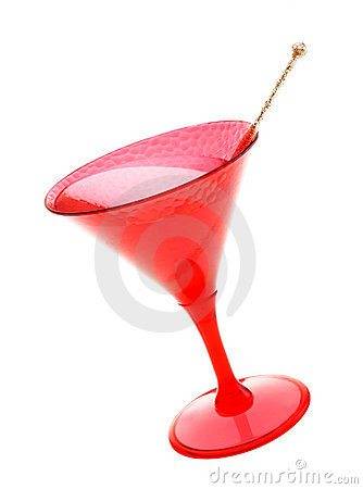

Hmmmm ... if someone with a nice modelling package could womp up a couple of pics for me - one of the situation and one illustrating the slices, exploded diagram style? That would be cool.
(I don't feel like arm-wrestling Blender - the other one I have is gnu-octave. I'd probably just edit a pic of a beer glass - hmmm... beeer...)
Here you go!
I used a different program to make it.
And here's another one:
It illustrates that you're trying to bend the laws of nature, just to be able to find out what you can directly measure if you poor it into a measuring beaker (without bending gravity to you own purposes)!
