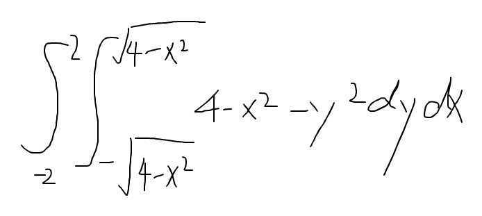

Find the volume of the solid bounded by z=x^2+y^2 and z=8-x^2-y^2
use double integral dydx

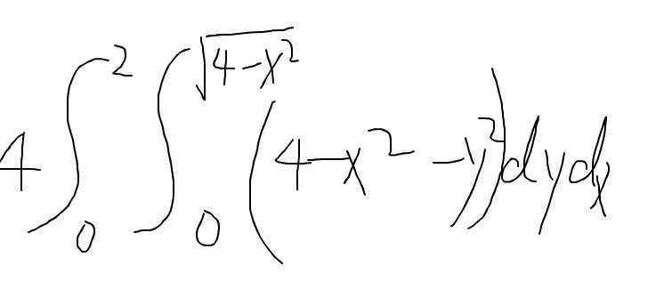

the textbook divided the volume into 4 parts,
[/B]
f(x)= 8-x^2-y^2-(x^2+y^2)= 4-x^2-y^2
i use wolfram and got 8 pi, the correct answer is 16 pi from the textbook.
I understood the textbook version, I see why its dividing into 4 parts since its symmetric about x and y axis, but I don't understand why my method is half of the correct volume. obviously I need to multiply my double integral by 2, but I just don't get the picture, I am confused, am I just getting the volume of the lower paraboloid with my setup like that?
what if the upper paraboloid has different volume as the lower paraboloid, for example, the upper function could be z=4x^2+y^2, then multiplying by 2 just doesn't make sense since the top and bottom are not equal to each other. can someone help me out, its been bothering me since yesterday.

The above is incorrect. ##8 - x^2 - y^2 - (x^2 + y^2) = 8 - 2x^2 - 2y^2##.

oopz, my bad.
omg, no wonder why! I was reading the text and just copied that down without even checking it. Thank you so much!
Recheck the text. Possibly it was [itex]8- x^2- y^2- (x^2+ y^2)= 2(4- x^2- y^2)[/itex] and you missed the "2".
Likes qq545282501

It is a lot easier if you switch to polar coordinates for x and y; then you don't need to divide anything into parts, you just need to use the shell method.

yes, you are right, i was not careful enough...
yes, indeed. Though, i was trying to make sure I got the concept down in my mind.
