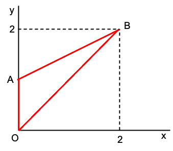

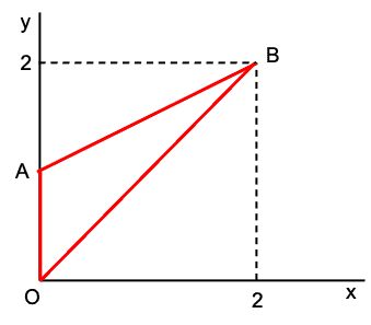

See picture below for the triangle of interest. You need the equation for the line AB.
(Edited to fix the figure as pointed out in post #5.)
kuruman said:
The lower limit for ##y## is zero only when ##x\leq 1##. See picture below for the triangle of interest. You need the equation for the line AB.
Point A should be ##(0, 1)##, according to the OP.
Likes kuruman
Oops. I swapped coordinates in my head.

Your bounds are still wrong. You are including the area above the line AB in post #4.
For a given x, what is the range of y within the triangle?

Now you've integrated over the triangle with vertices at ##(0,0), (0, 2), (2, 2)## .
Use the figure given by @kuruman
What is the equation of the line passing through O and B ?
What is the equation of the line passing through A and B ?

y=2x-2? No. Try plotting that on the figure... :wink:
Thanks, while writing down I swapped x and y. 0.5x+1 is AB
Likes berkeman
Great. So how does that change your integrals? :smile:
the inner integral has to go from x to 0.5x+1 xy dy and the outer from 0 to 2 dx I guess?
Yes
