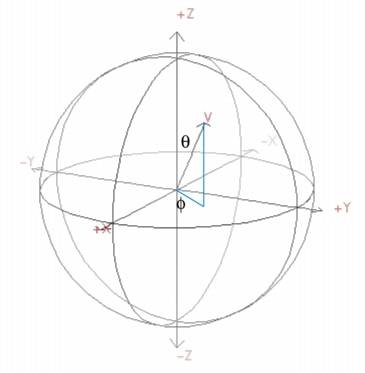

yup did that. as well. Here let me try to explain again (sry I am new to forums don't know how to use the coding)
(this is not from my question but makes it easier for me to explain)
Im only given the radius as R and they want me to calculate the volume of the sphere that is filled with liquid (point h on the z axis). since there is no numbers the answer is going to be a formula. so when i integrate the area of the cross section (using the element of dz as you mentioned) i get the "theoretical" volume equation for the entire sphere which us 4/3 pi r^3 (which is just deriving the formula itself).
For my question, how can i find the partial volume of the sphere given only the height (point at z axis).There are sites that do this for you (http://www.onlineconversion.com/object_volume_partial_sphere.htm), but i need to derive the formula using calc but i can't :(
thanks for your help man, i hope this is more clear
hmm maybe the equation for the volume of spherical cap? since that's what it really is. but i need to know how to derive it
I can see where it would be difficult to get the answer you want in Spherical coordinates. The geometry of your problem lends itself to a rectangular coordinate system. Try an integral in terms of x,y, and z. You can now easily specify the limits along one axis from the bottom to some height h.
Draw your picture!
Pick a sphere filled to height 0<h<2R centered at the origin with z the up axis. Its equation is x^2 + y^2 + z^2 = R^2. The cross sectional areas will be circles and you'll have to figure their area as a function of z indicating the vertical position at which you slice.
You'll integrate A(z)dz with limits chosen so the z-coordinate spans the part of the sphere filled. You still must do this yourself, I'm not going to give you the limits of integration.
You say you've done this for the whole sphere. Look at your picture for the partially filled sphere. At what z-value is its top sliced off?

omg i think i got it ! I can't believe it was that simple. so the limits of integration from -R to h - R and the same equation i use to get the whole volume. I didn't actually do it yet i need to get to class but this makes SO much sense (i think at least)
