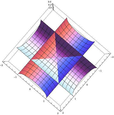

Find the volume of an object bounded by x2 + y2 ≤ 1, x2 + z2 ≤ 1 and y2 + z2 ≤ 1.
This stuff is very new to me (multiple integrals to find volume) so I am not entirely familiar with it. My first thought was to put each boundary condition in terms of one variable. For example, solve the first 2 boundary conditions for y and z in terms of x, but then if you substitute them into the third boundary condition, it doesn't really get you anywhere.
Any help would be much appreciated.

WHOA THERE everyone. That solid is NOT a sphere. It is the intersection of three cylinders.
I was just coming back because I seemed to encounter some issues. I am not sure how to fix it at this point. My classmates have told me that the answer should be 8(2-sqrt(2)), which just so happens to be pretty much exactly 1/2 of what I got following the previous steps. How would I account for them being cylinders in order to fix it?

Surely not!
Any point inside the unit sphere is inside this intersection of three cylinders, but the converse is not true. This intersection of three cylinders circumscribes the unit sphere and is in turn circumscribed by a sphere with radius ½√3.

Not going to lie - I can't visualise this at all now. To me it seemed like a blatant sphere. I've just done a bit of a model on Mathematica and yeah it looks like the intersection of three cylinders really doesn't form a sphere.
OP... I'm really sorry for misleading you. At least I taught you something about spherical co-ordinates...? Heh.
Please do let us know when you find or are given the solution. I'm very curious now!
A classmate of mine showed me the integral that they set up to solve the problem to get the result of 8(2-sqrt(2)) but I cannot quite figure out why.
They set up a triple integral as follows:
16 0∫π/40∫10∫(sqrt(1-r^2cos^(θ))) [r] dzdrdθ
Any ideas where this comes from?
edit: the integral should be read as follows:
the bounds on the first integral go from 0 to pi quarters. The bounds on the second integral go from 0 to 1. The bounds on the third and final integral go from 0 to sqrt(1-r2cos2(theta))
Hmm they've used cylindrical co-ordinates, which is basically polar co-ordinates for the 'base' and cartesian for the z-axis, usually given as (ρ,θ,z), where ρ is the radius and (ρ,θ) are confined to what would be the x-y plane. For example (1,π/4,1) has cartesian co-ordinates of (1/√2, 1/√2, 1)
It's multiplied by 16 because it's easier to break it into 16 sections, work out the volume of just one of the sections, then multiply to get the full volume again. If you look at this image, you can see how the cylinders cross each other. Draw a circle onto the centre of that shape, to represent the other central cylinder, and you'll see it forms 8 similar segments. So if you keep in mind that the shape has a bottom half to it as well, that makes a total of 16 segments.
Looks like the first integral, from 0 to root(1-r2cos2theta, defines the height of the thing from 0 to its maximum point, for all points. I don't know how they came up with this, but it's presumably taken from something very similar to the spherical co-ordinate properties you gave me before, where you said:

That's ##16\int_0^{\pi/4}\int_0^1\int_0^{\sqrt{1-r^2\cos^2\theta}} r\,dz\,dr\,d\theta##.
So where does that come from? The answer is symmetry (the factor of 16) and use of cylindrical coordinates (integrating in terms z, r, and θ). The second part is easy. When you are using cylindrical coordinates to find the volume of some object, the integral is ##\iiint_V r\,dz\,dr\,d\theta##, where the integral is over the volume V. That the Cartesian ##dx\,dy\,dz## becomes ##r\,dz\,dr\,d\theta## under transformation to cylindrical coordinates is derivable, but this is one of those key things you should just know.
The factor of 16 and the integration limits -- that's the tricky part. The basic idea is to use symmetry to divide that complex shape into something that is more readily integrable. A common approach is to see if there's some way to divide the volume in half. In this case, it should be obvious that the portion of the volume about the z=0 plane is exactly equal to that below z=0. Restraining z helps simplify things. In particular, if z is positive, √z2=z. Similarly, it often simplifies things if one can use symmetry arguments to keep x≥0 and y≥0. Combining these three, if you can keep each of x, y, and z positive (i.e., the first octant), you don't have to worry about nasty problems such as √z2=-z (and the same goes for x and y).
So does that kind of symmetry exist with this problem? It certainly does. In fact, there's yet one more symmetry of which one can take advantage. xy when the cylindrical coordinate θ is between 0 and pi/4. That means that the cylinder that constrains the z coordinate is x2+z2≤1, or z2≤1-x2. Since both x and z are positive in this region, this is equivalent to ##z \le \sqrt{1-x^2}## -- and that's where that final integration limit comes from.
