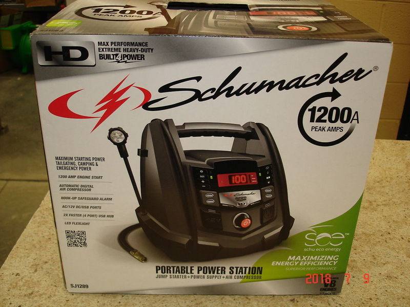

I think you should go with the air pump. Something like this (about $100 @ Walmart) is a good thing to have in your car or truck anyway. This one can deliver 100 psi (I don't know the cfm), and will automatically limit to a preset pressure:
