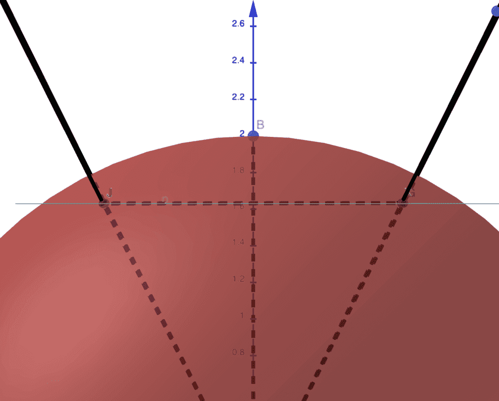

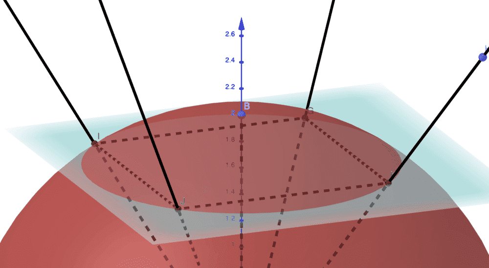

Arghh, this does look quite tricky. Because the cap is weird... sketched crudely:
I think setting up the square with vertices on the axis, and then concentrate on the main quarter/octant would make things easier. It cuts out only one plane. (I'm still struggling with the demo version of my graphics program. What do you use, @etotheipi?)

Let the centre of the sphere be O and the base of the pyramid be ABCD. Consider the planes containing OAB, OBC and OCA. These intersect the sphere's surface in three arcs.
Find the angles between the planes, hence the angles between the arcs. A neat formula relates these to the area of the triangular cap the arcs form.
Find the volume between the planes and that cap from the area.
Likes etotheipi
@EquationOfMotion , were you able to follow my method in post #12 to get the answer or do you need more detail?
It's been a week and, disappointingly, the OP seems to have lost interest, so I'll post the full solution.
The angle between two faces of an octahedron is ##2\arctan(\sqrt 2)##.
The arcs where the planes containing OAB, OBC and OCA intersect the sphere therefore form one angle of ##2\arctan(\sqrt 2)## and two of ##\arctan(\sqrt 2)##.
The solid angle that a triangular cap with angles α, β, γ subtends at the centre of the sphere is Ω=α+β+γ-π, so in this case ##\Omega=4\arctan(\sqrt 2)-\pi##.
The volume is ##\frac 13\Omega r^3##.
